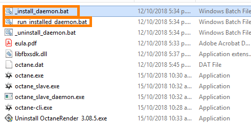

Slave Daemon setup:-
- Bring up an Explorer window then locate the Octane Standalone folder then run _install_daemon.bat to install the slave daemon.
You can press Enter key 5 times to set up as default or choose to set up manually.
- Run the _run_installed_daemon.bat batch file. Make sure to keep it running..
