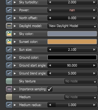

I just opened the last scene I was working on as well as a couple of older ones and I was able to replicate it in each and everyone.
@Drawfun, the nodegraph has the Power of the daylight/hdri set to a none number "NaN" during the bug. It jumps back to whatever I have it set to in blender world tab when the bug goes away.
#update: Other values does this too... Just had 2 frames render with 2 different directions for the daylight system. (Obviously with unchanged settings from my end..)
- Attachments
- NaNBug.jpg (75.55 KiB) Viewed 2813 times
