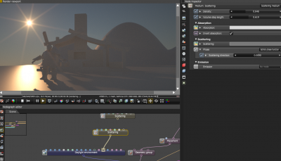

Hello. Please help me to solve this problem. I tried to solve it a year ago but some answers that I recieved was only redirection to another forum posts. I could not repeat them.
I make the same fog in my scene with Medium Scattering that I saw in the lessons:
https://www.youtube.com/watch?v=mGQI5_gjgzs
https://www.youtube.com/watch?v=mWi8M4DeCBc
Unfortunatelly there are not lessons about fog for Octane standalone, there are only for 3DMax or С4D.
When I apply Medium Scattering the scene fills by uniform color but not with fog effect.
I want the fog to fill the scene correctly - near objects should be contrast and far object should be hiden with removal.
What to do? I tried to setup all the settings. I repeated evry setting like in those videos. Please, describe what exactly to change. Or here is my scene, show me right in it.

Try to play with density number - 5, 10, 50, 100 until you see effect. Also check the Medium radius (Environment node).
