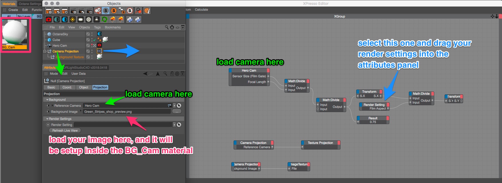

This is a setup I've been using for a while to calculate exactly what Ahmet pointed out.
It still needs some work to be more user friendly, but it works for me. ;)
If any xpresso gurus want to add to it, feel free. Ideally camera and render settings would only be loaded in the main attributes panel.

niestudio wrote:This is a setup I've been using for a while to calculate exactly what Ahmet pointed out.
Thanks for this dude.
I'd love it if there was a simple preset within the project node (like with the other projection methods) that just instantly gives you full a full screen projection like with C4D's own setup. My worry is that if I don't do this for a while in Cinema, I'll come back to it and totally forget how this was set up or that I used this XPresso set-up to get it working. Next thing you know it's back down the back of the internet again to try and work out how I had it working before (I literally had this all worked out last year but it's so complicated I had just forgotten how to set it up).
Also, I'll be honest, I still don't fully understand the logic behind the math. I can see the "how" I just don't understand the "why".
Also, do you mind me asking why the render settings need to be dragged into the field in the attributes manager? I can see it's taking the film aspect ratio for the division but I was just curious as to why it needs to be dragged in there manually?

Camera_mapping is simply like projecting a texture to screen. So It's fixing width of image to screen's left and right borders and adjusting the height from what ratio you give.
