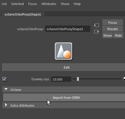

I think maybe you are talking about "ORBX proxy" here, not about "ORBX material" (which is a different node containing only material information).
To import ORBX or OCS file in an "ORBX proxy" node just create an ORBX proxy node from the Octane menu
then click on the "IMPORT from ORBX" button:

You can import either an ORBX file or an OCS file,
- to create ORBX file just use File>export selected>OctaneRender scene (or OctaneRender animated scene)
- to get an OCS file just open the ORBX file in Standalone and use "File > unpack package", this will unpack the ORBX to an OCS file + an asset folder (this is like unzipping)
But most of the time I use ORBXproxy another way,
example :
- export an animated mesh as Maya builtin Alembic cache (cache menu)
- Octane menu >ORBX proxy
- Attribute Editor > EDIT button
- Edit Window > drop the ABC file in the Nodegraph Editor
- Connect out geometry ( pink pin to pink pin)
- run IPR in Maya to get feedback while you setup the Materials fot the ABC/scene node in the EDIT window.
- close EDIT window to validate the change.
