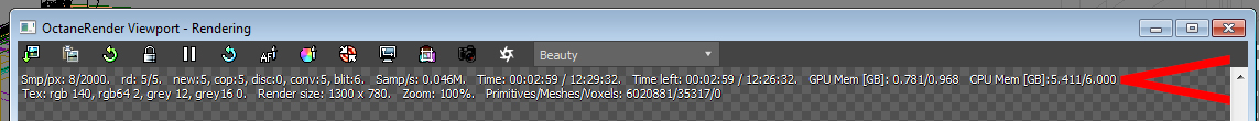

Hi Paride,paride4331 wrote:Hi jan kudelasek,
Octane 3.08.x CPU mem works only with textures, not geometry.
Octane 4.0.x CPU mem works automatically when needed (textures + geometry).
If it is working you can check this as in the screenshot.
Regards
Paride
