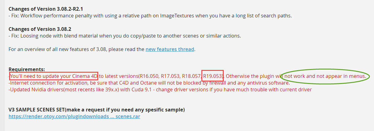

Please read install notes for minimum requirement for C4D

aoktar wrote:Please read install notes for minimum requirement for C4D
Please read my system specs above.
Please read this!

Ahh, now that's a more useful response. I had to update my C4D. Thx
