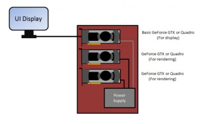

You should connect your monitors to primary graphic card but not use it with Octane (disable it In Octane device).

even not using the main display card makes 3ds max slow.( moving object, changing textures with octane viewport opened makes max very slow eventually ). may be 2018.4 3ds max bug
