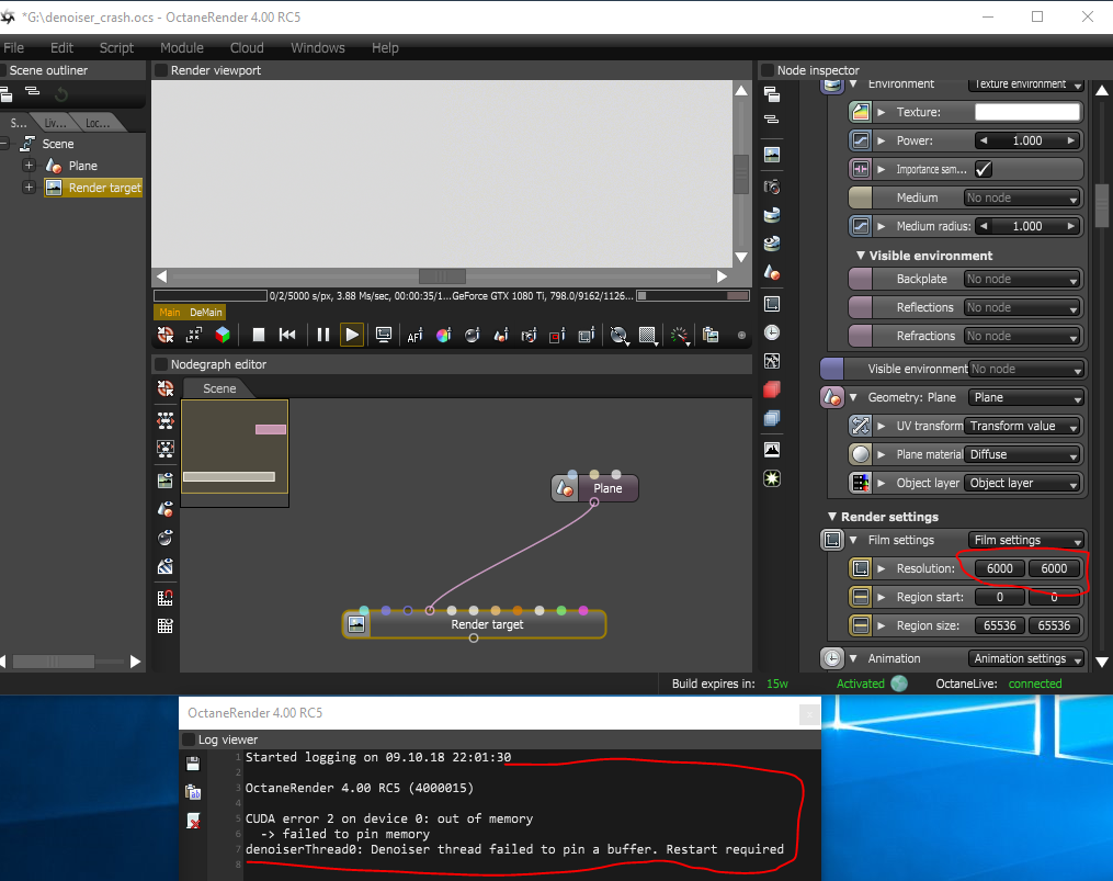

Hey guys, someone got in touch with me about denoiser crashing on his 8k image.
I had a look at this older XB thread, and it seems we should be able to denoise any res octane supports: viewtopic.php?f=33&t=67492
Added tiling and multi-GPU support for the AI Denoiser. You can now denoise any resolution up to Octane's maximum, and the Denoiser will consume less memory per device (approximately 450MB per device maximum).
I tried denoising in modo at 8K res. The scene just contains a single cube. The render takes ages to appear, and system RAM usage hits 12GB, which seems unusually high (RAM usage is about 4GB without denoiser). Why is system RAM usage so high?
I don't get a crash, but the denoiser fails with this in the error log:
Code: Select all
CUDA error 2 on device 0: out of memory
  -> failed to pin memory
denoiserThread0: Denoiser thread failed to pin a buffer. Restart required
Im using a 1080ti with 11GB. The denoiser works at 4k. Is this a bug?
EDIT 2: I also tried in standalone rendering a geometry > "plane" item at 6k with denoiser. The same problem occurs. GPU-Z does not show my VRAM anywhere near full, so this must be related to system RAM?
denoiser_crash.ocs
(62.79 KiB) Downloaded 258 times
Win10 Pro / Ryzen 5950X / 128GB / RTX 4090 / MODO
"I am the resurrection, and the life: he that believeth in me, though he were dead, yet shall he live" - Jesus Christ

Posts: 5513
funk wrote:Hey guys, someone got in touch with me about denoiser crashing on his 8k image.
Code: Select all
For the the denoiser to work we are rendering quite a few more passes (which you don't see), which require a lot of system memory. The denoiser then needs to load them to the GPU. The way the denoiser works right now the channels of these render passes need to be pinned, which can fail if it's too much.
-> It's a limitation, but we are currently refactoring this area, which should remove the requirement to pin and release an update when that's done, but it will take a few of weeks to have this properly finished.
