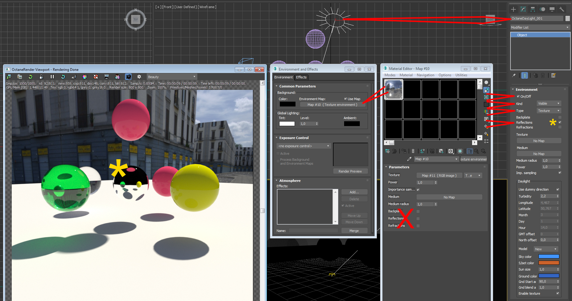

https://yadi.sk/i/vIjoZ1eTSDR-qw
Hi Goldisart,
the correct workflow is like in the screenshot; the options you show refer to SDK workflow, I will ask developers to to remove them.
Thank you.
Regards
Paride
