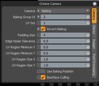

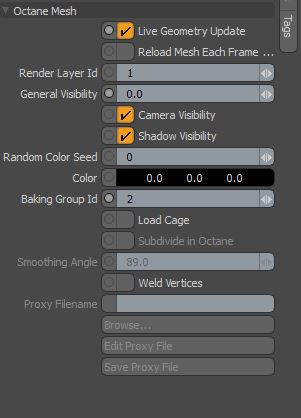

2) Set the General Visibility of the lopoly mesh to 0 and baking ID to 2
3) Use the EdgeSplit Command (don't use the procedural EdgeSplit since it will delete the UVs) edit: You can bypass this by using a polybevel at 0 and delete previous operation (in some cases there are artifacts though)
4) Use a procedural push. I start with 5mm and try and error to the best setting
5) Use a procedural Polygon Flip
6) Set the Camera to BakingCamera BakingID to 2 and check RevertBaking
7) Start to render

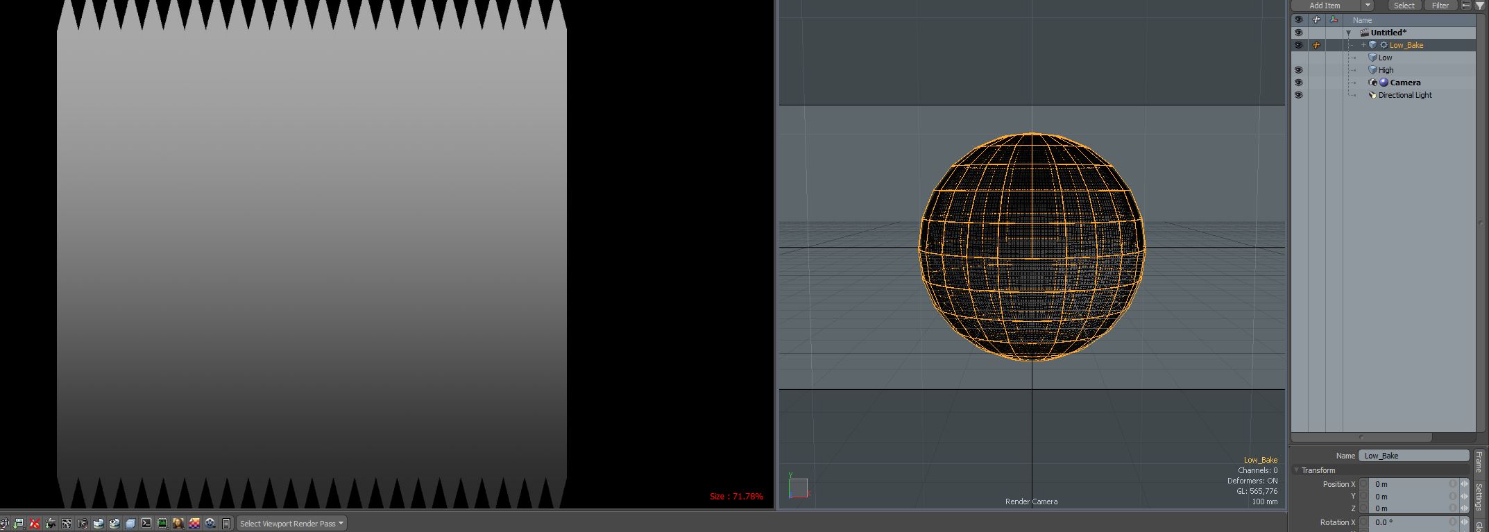

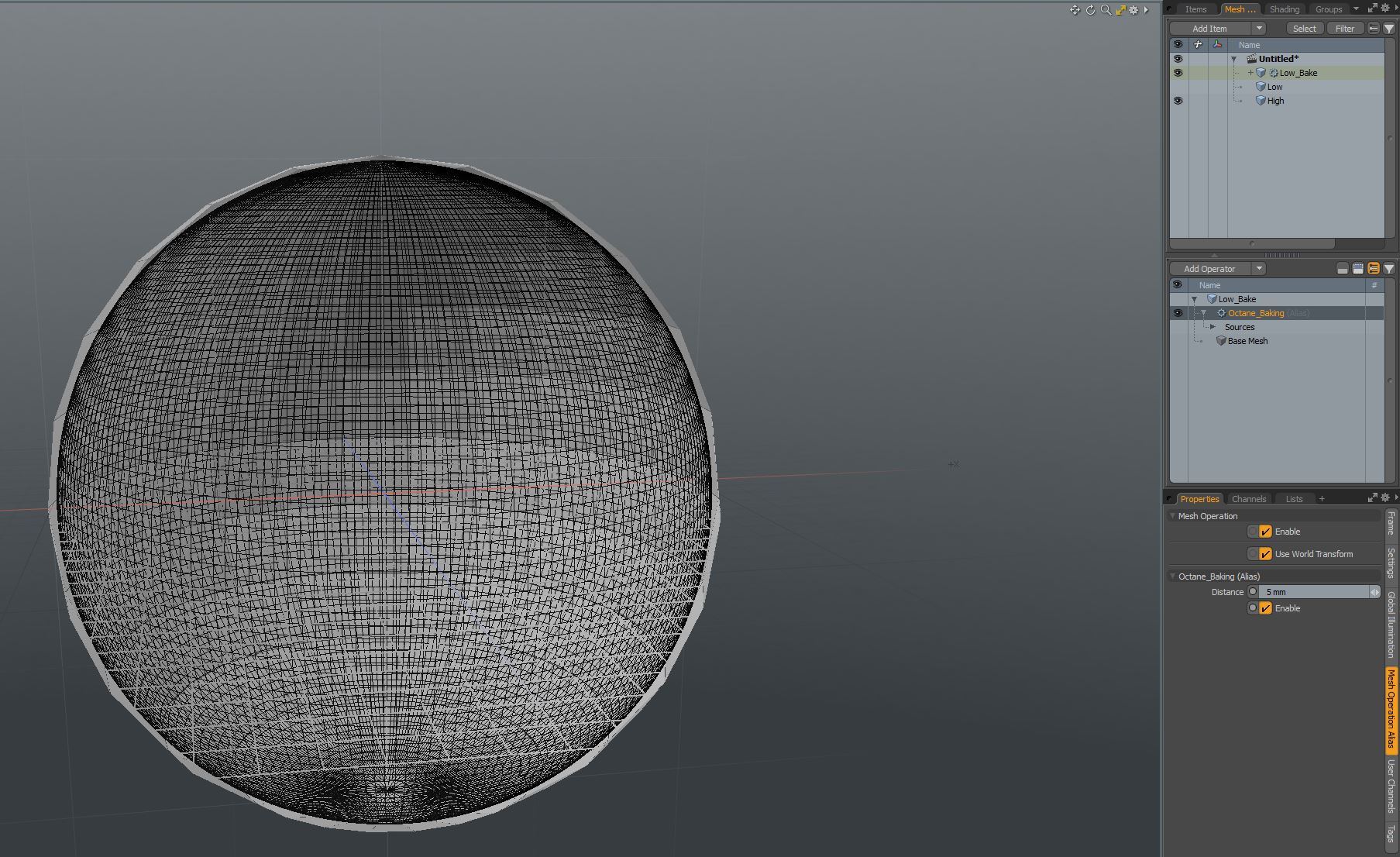

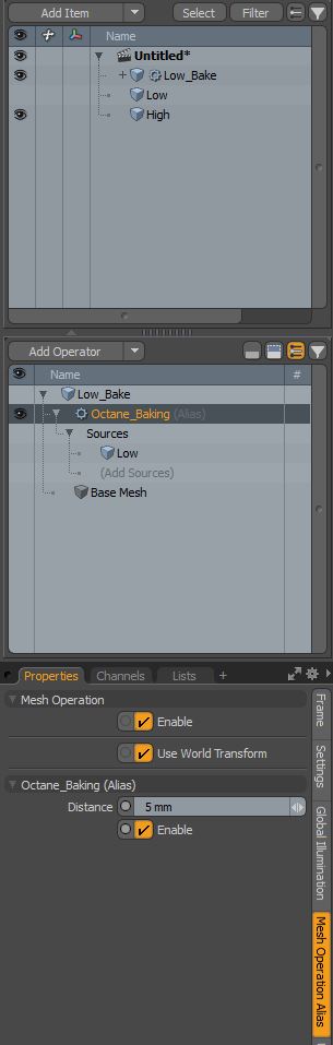

to make things alittle easier, i made a meshop to divide, push and flip the geometrie. I also added some screenshots how to setup modo.
There are two settings:
First the Bakingdistance
Second a switch to disable the flipping of the polygons. This is usefull to see if there is a overlap with the highpoly geometrie
