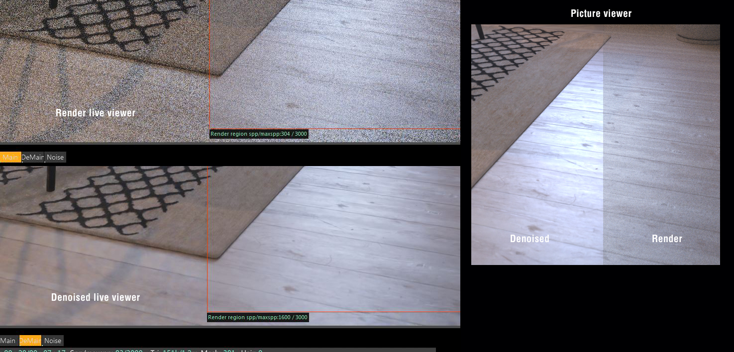

Is it possible, that highlight compression (set to 1) isn't applied to the denoised beauty rendered in picture viewer? Or am I missing some settings? In Live viewer everything is fine. Rendered in picture viewer gives me this result (see image attached).
I need to check stuff with linear workflow etc. where my knowledge is very bad, but I tried to set everything to linear.
Comparison done with R20, V4 RC5

thorwaldhoffmann wrote:Is it possible, that highlight compression (set to 1) isn't applied to the denoised beauty rendered in picture viewer? Or am I missing some settings? In Live viewer everything is fine. Rendered in picture viewer gives me this result (see image attached).
I didn't checked but With Linear buffer type on passes, you should not expect Camera Imager applied. Linear means that's having pure(untouched) render results. No gamma, not Imager effect

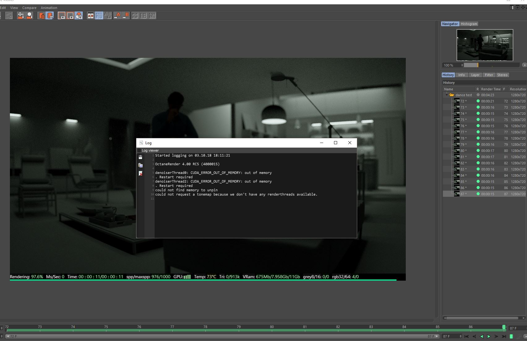

we did some test renders with the new build today and noticed that our renders always stopped after 40 - 70 frames, when we had a denoiser pass activated. If we turn off the denoiser pass everything rendered fine, no problem. The log showed the denoiser cuda error. Are we missing something? Do we need a new cuda version?
Otherwise the build is pretty amazing and works great for us.

Weirdpictures wrote:Hi Ahmet,
Thanks for the hard work,
Martin
Hi. I had the same problem + some random crashes when rendering or when working with live viewer. I hope V4 will get "stable" soon.
