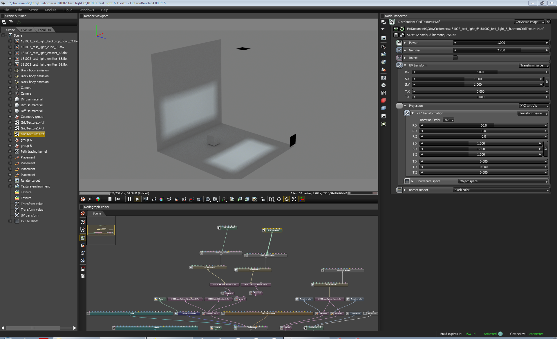

Hello,
tried to achieve an easy to handle barndoor light effect with rectanglular pattern image in distribution node of blackbody emission. Projection mode of image is set "XYZ to UVW" in object space and if I rotate the emitter in octane via transform node the pattern light is following accordingly.
But when I import rotated emitting mesh then beams are not following the normal of the surface. This is strange and should more be like IES files, of course the rays should follow orientation of surface and in workflow I have to import numerous emitting surfaces in my scenes.
Any solutions?
Best,
Andreas

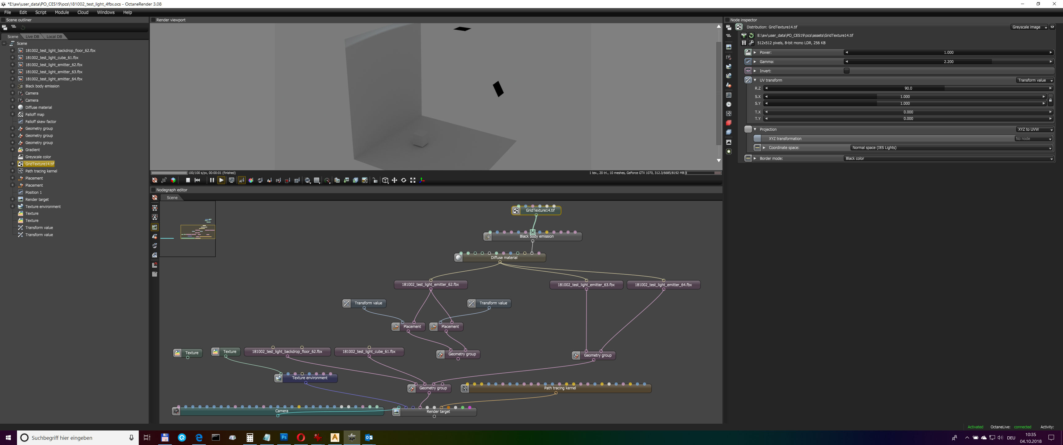

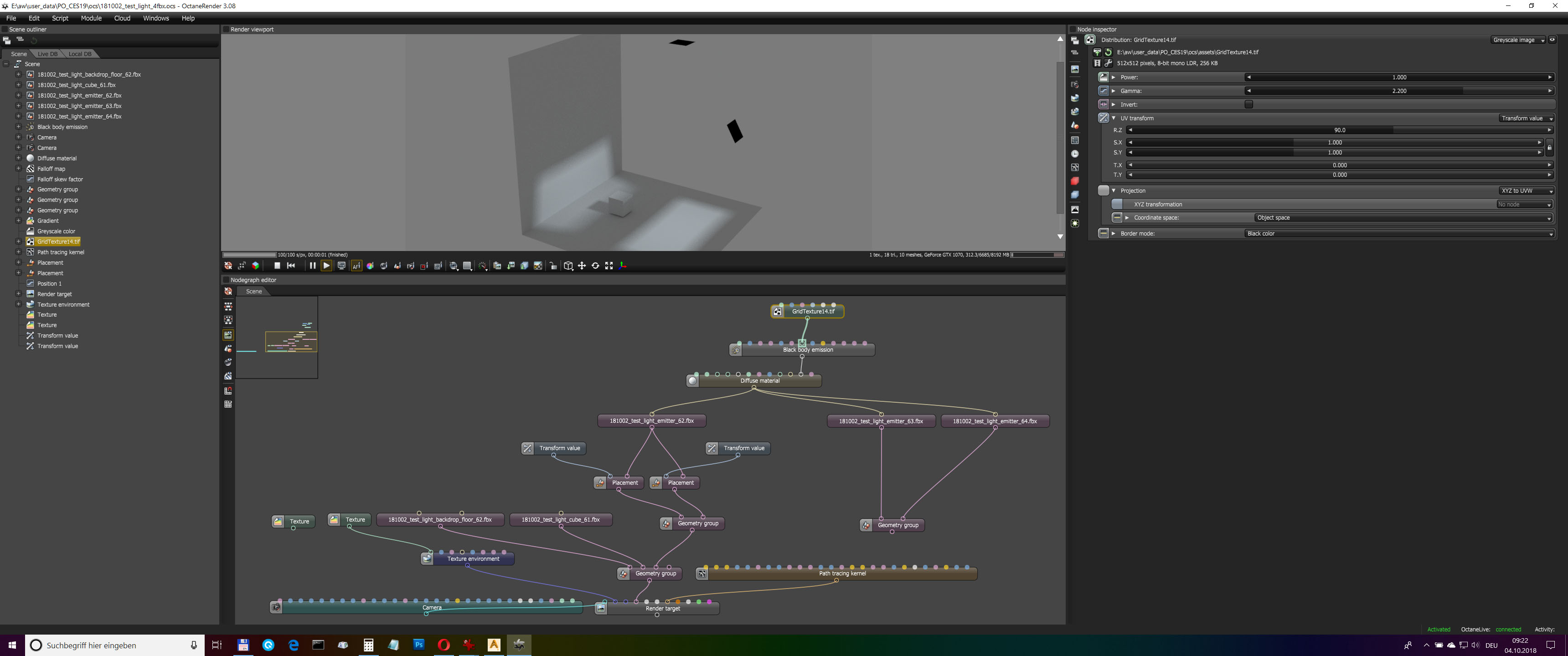

Thanks for your reply Beppe,
already tried a lot:
here with IES and "XYZ to UVW" projection mode
and here with IES and "spherical" projection mode and some scaling, where the rays follow the surface but the square pattern file is totally distorted/ignored.
I thought the 2nd option could be a solution but now I am wondering why tranforms within Octane work perfect but imported objs are handled so differently - this makes no sense.

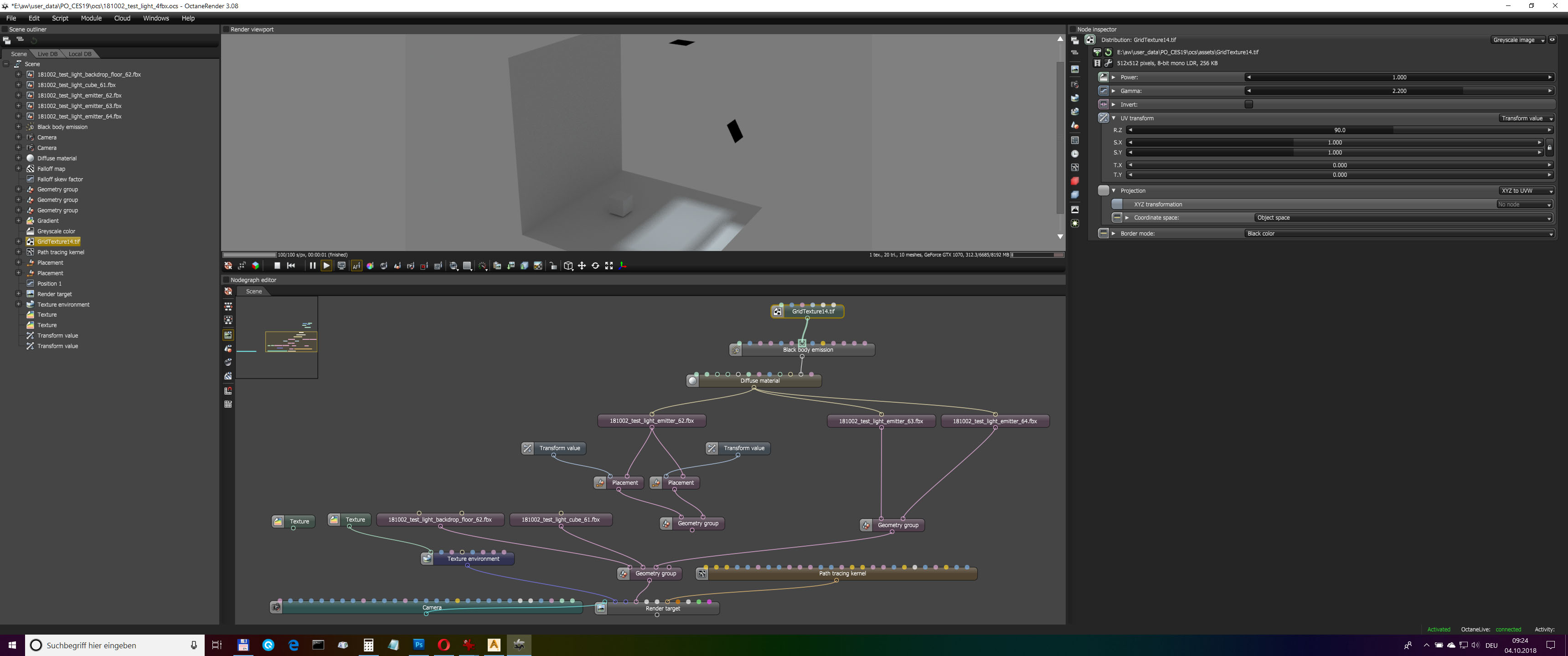

Hi Beppe,
thanks for asking. Please find attached the associated file and switch between group a and b meshes to see the difference between imported and transformed planes. I also tested with obj instead of fbx but it makes no difference.
Would be great to get some help and to be able to have a patterned light (gobo/barndoor...) like discribed in the manual.
Best,
Andreas
181002_test_light_6.orbx
(189.63 KiB) Downloaded 192 times
Posts: 10598
thanks for the scene.
If you assigne the same rotation of the plane in the projection node, everything is working as expected, in uvw-planar mode, object space, so you need a different material per different rotation:
181002_test_light_6_b.orbx
(206.21 KiB) Downloaded 178 times
ciao Beppe
