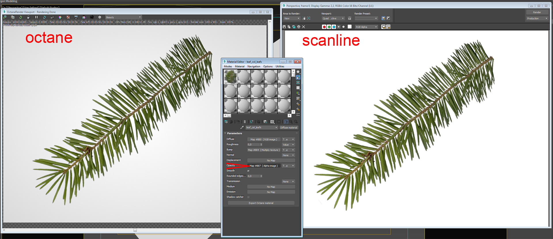

If you run the material converter on a standard material with an opacity map, a couple bad choices are made:
1. The gamma is set to 2.2, when it should be 1
2. A tif image which is set to mono channel output=alpha in the standard material is imported as an Octane RGB map, when it should be an Octane alpha map. This should be checked for tga, and png files as well.
The bump maps also get imported with gamma of 2.2, though at least the converter chooses an Octane greyscale image.

The gamma for any map other than diffuse should not be anything other than 1 by default. This includes: bump, displacement, emission, alpha, etc. If the gamma is 2.2, values which are meant to be half(0.5) get converted to 0.21.
In your comparison, you can see that the alpha map in the Octane version is contracted compared to scanline. The needles are smaller and thinner! This is because the gamma is improperly set to 2.2, rather than 1.0. It's not correct. The material converter should set the gamma to 1.0 for every map except diffuse.
