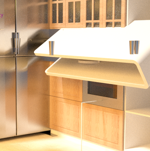

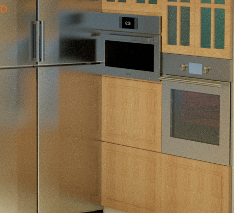

Hi!
There is a problem with ORBX proxy exported form cinema 4D (I don't know it's matters).
Some of geometry is changing it's position, scale and rotation. Sometimes restarting maya helps, sometimes not. I'm not sure but it looks like there is more and more failing objects in peroid of time.
Is it possible for You to add file an path information where OrbxProxy is referencing to?
This is how it schould be (Octane Standalone)
This is how it looks in maya (light plane is also moved)

Vyoor wrote:Hi!
Hi Vyoor,
We are not able to replicate this issue. Are you using multiple Orbx proxies in the scene?
Create a new Maya scene and try to disable/uncheck the Unpack ORBX resources from the Octane render tab.
The proxy would read the ORBX file directly without unpacking then scene contents inside the Assets folder.
If this does not solve the issue, please PM me the ORBX file for us to resolve quicker?

Vyoor
Posts: 67
Joined: Fri Jul 12, 2013 8:18 pm
I'm using only one Orbx file. Unfortunatelly unchecking "Unpack ORBX resources" is not help.
Next thing - maya is crashing when unloading/removing/replacing references with some octane materials. This is critical problem for me right now.
