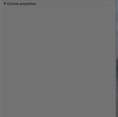

Hello,
New to Blender Octane.......I know this must be obvious, but I cannot find the toggle to Turn Off Object Shadows. In my Carrara Octane Plugin, this function is nested in an Octane Object Modifier.
No such Modifier in Blender, so I looked under the Object panel. While there is an Octane properties tab , it is blank for the object selected ( actually, nothing shows for any object selected).
The Octane Imager Presets ( in the "N" panel of 3D view) also offers no shadow object options.
Thank you for your help,
Rick

Ahhhh..... Seems there is a decoy Octane Properties panel, and this is the one I was looking at.
With an object selected, if I look in the panel designated by the little cube, I see the blank Octane panel.
With the same object selected, if I look in the panel designated by the Triangle ( per the manual, as Whispermode kindly pointed out) I do indeed
find the desired options.
