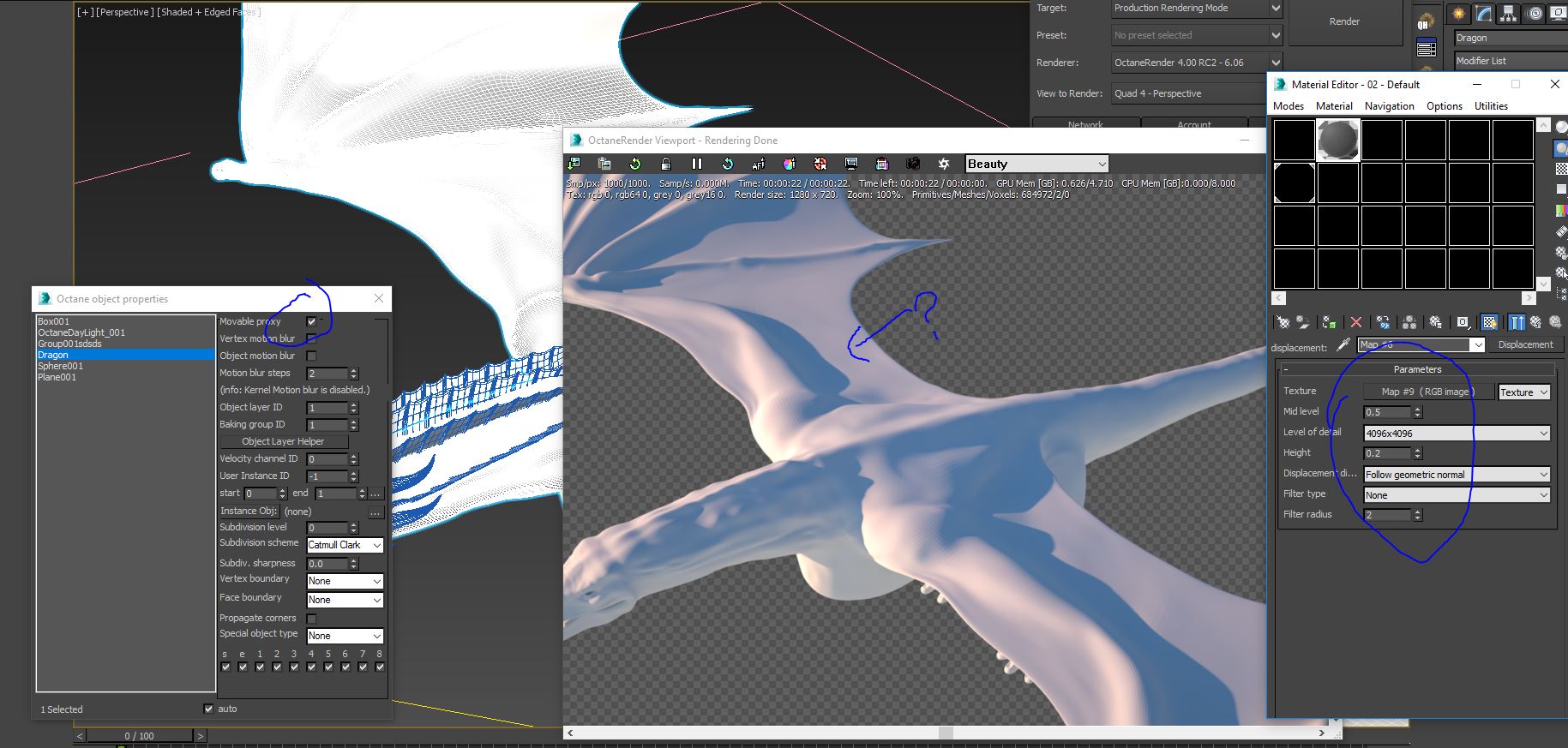

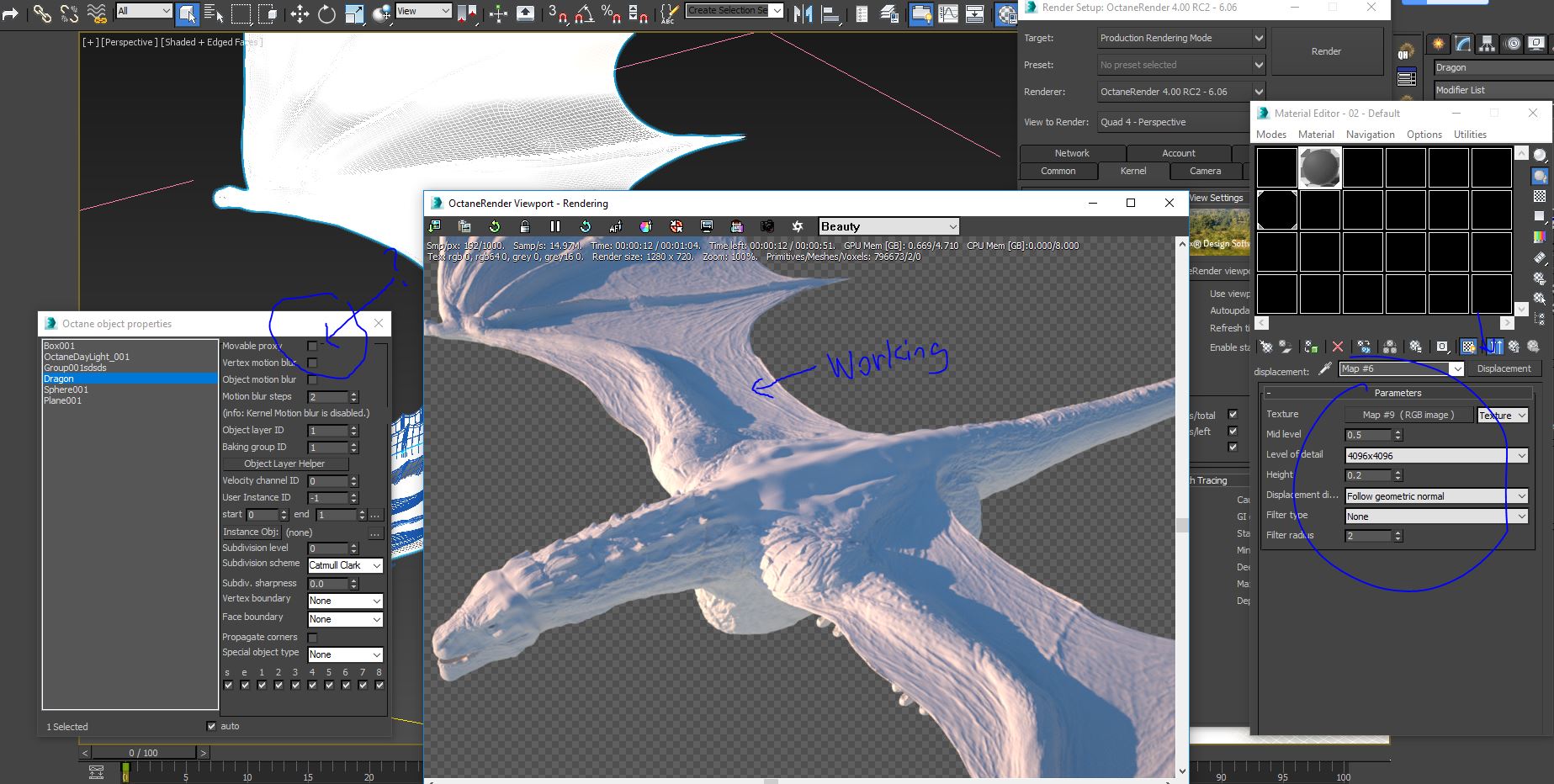

Hi guys,
I am on OC 4.00 RC2-6.06 3dsmax 2016 version , I got this problem my displacement only renders when I tick off Movable proxy on mesh ?
When I turn on Movable proxy displacement is gone ? could someone help out on this issue thx
We need it for testing animation.
Jimmy

Hi Jim99,
I tested your issue using 3dsMax 2016 and OC 4.00 RC2-6.06, but everything works fine.
Could you share in pm your file so I can test it, I'd like to undestand what happen to you.

Hi Jim99,
I tested your issue, it does not happen with all the geometries.
I tried to merge the dragon in a new scene but the issue is still there.
i don't understand why that so I sent your scene to developers.
Regards
Paride

Hi Jim99,
A workaround waiting for a fix is to use Reset XForm on the mesh.
Regards
Paride
