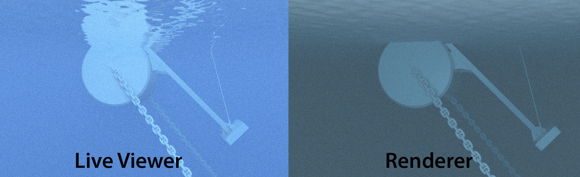

I'm making an underwater scene, which is going fine, but when I want to render I get a difference between the life viewer and the renderer. What can be the problem here?
I'm using path tracing for rendering. I haven't changed any other setting.
[SOLVED] Difference between Live view and Picture View.
Ok, this issue is solved. In the render settings I had 'Ignore Unused Materials' switched on. Once I switched it off the renderer funcioned normally.
