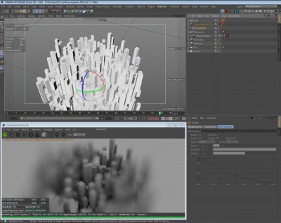

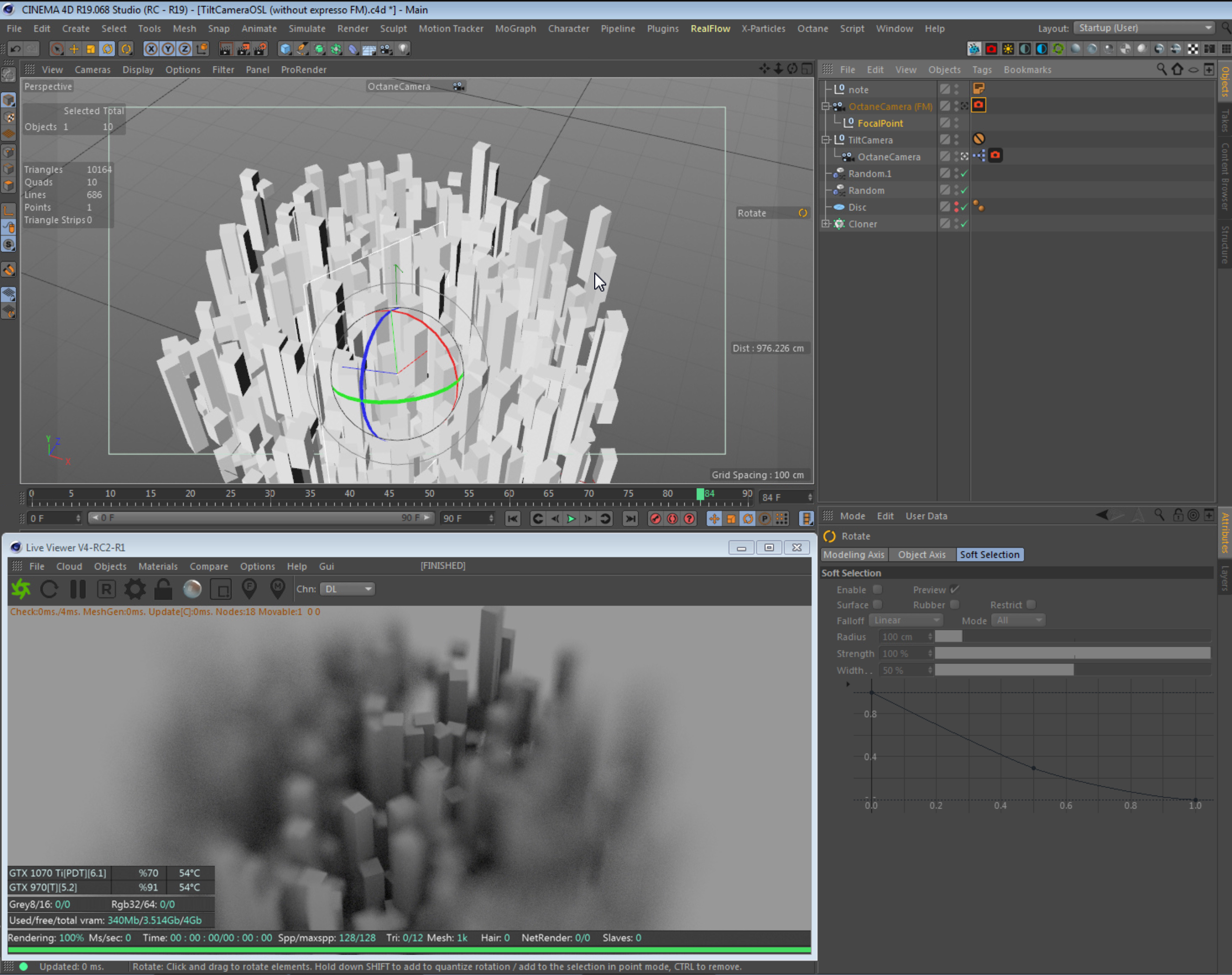

Edit: just had a quick look at it, what I discovered:
How come the FOV in the Live Viewer doesn't match with the Viewport? See the attached Screenshots:

KeeWe wrote:Wow, thanks a lot. Gonna try it out as soon as I have some spare time. Great community work, even platform independent. :)
Hi KeeWe,
There is a process by which an OSL camera can 'read' the FOV settings of your host camera, but it appears to be broken in Lightwave (not sure about other hosts). To get around this problem, I added a FOV input into the OSL camera. You have to control this directly rather than relying on the host camera providing that info. Have you tried adjusting the OSL FOV to match your C4D camera's FOV?
Cheers,
James.
