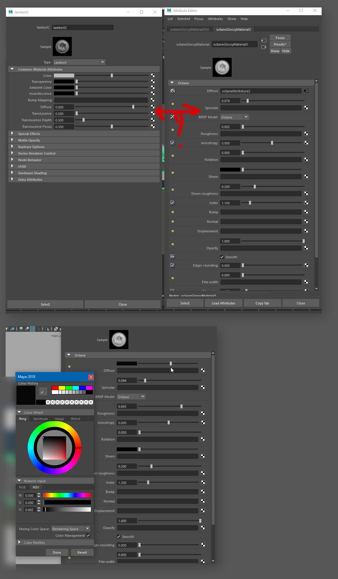

1. >>- This issue has been resolved in the Stable release [ viewtopic.php?f=109&t=68758 ]. We are currently working on V4-RC4 and will be available soon.
There's still a problem, I'm not sure if that's related just to old scenes or to all of them:
when I'm opening the scene from 13.5, rubber material's diffuse set to 0.001(one I mentioned before),
but AE shows that color slider is set to the middle value (0.5 or so).
(see pic)
2. Changing the AE layout cannot be done at this stage as there are many restrictions with Maya API itself. The plugin uses the best that it can squeeze out of current Maya APIs. We have plans to improve the Octane material converter sometime in the future releases.
But it's done already by multiple other vendors? Arnold, Redshift, Mental Ray, etc.
See the pic, at the left there's standard Lambert UI, at the right - Octane shader.

Hi Joss,
1. Could you please PM us a sample scene to investigate, we just need the Diffuse applied in any Maya primitives?
2. We would request if the UI can be redesigned and give you update.
