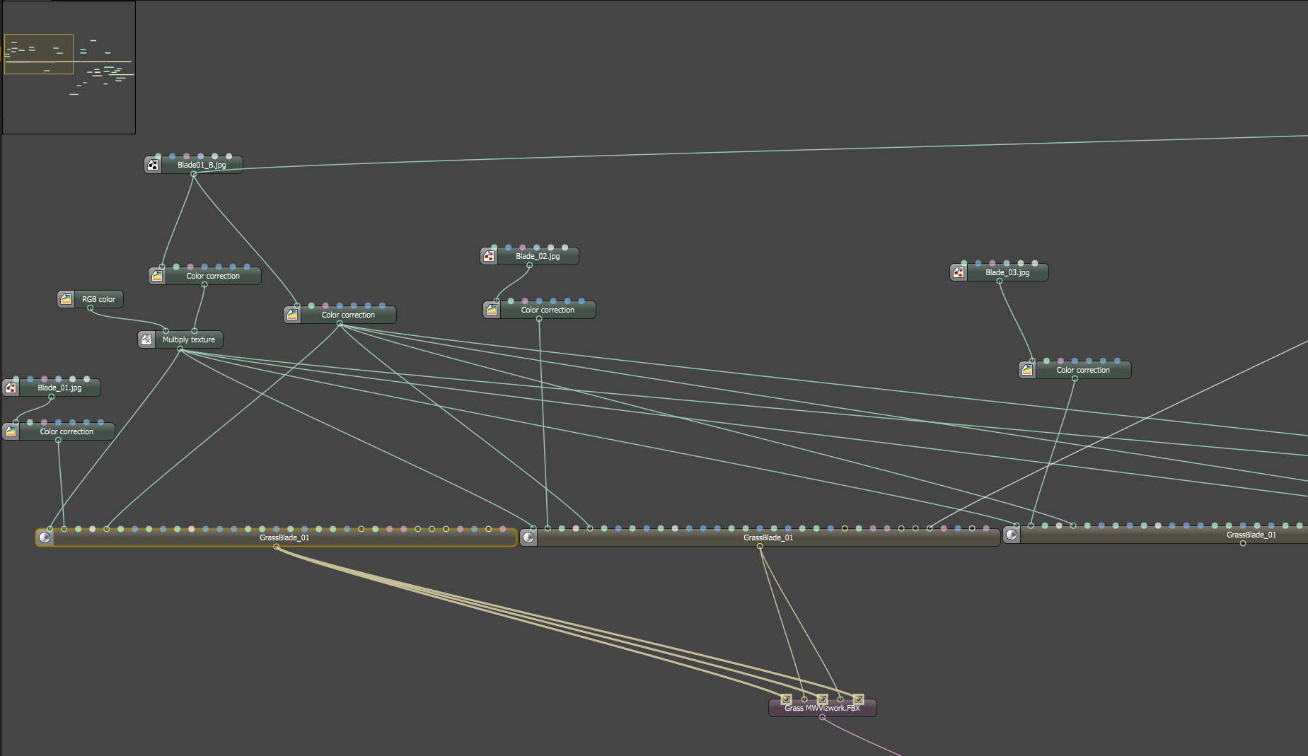

Cap, when connecting proxies to obj .ocs/ .orbx/ .obj/ can you make the plug-in connect it to its own node graph (see pics below).
And please make it remember the layout/setting
and please don't auto-delete floating nodes!
ocs are often complex, and this would make the "Nodegraph editor" chaos a little less annoying.
