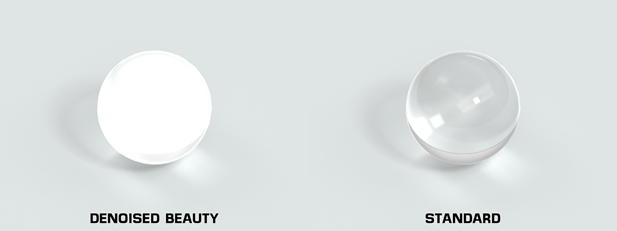

Something is wrong with Specular Materials in the Denoised Beauty pass. It's completely blown out. The undenoised pass looks fine.
Here's a comparison of the two versions (Denoised Beauty - left, Normal - right)

Disable "Affect alpha" in ball's material settings and it will be ok. This is Octane engine bug not plugin's.

Yeah - I'm aware that it's an issue with the render engine in general. But I'm a Blender addon subsrciber, so I posted it here. I hope it finds its way to the right developer.
It might work if I disable "Affect Alpha", but I need it.
