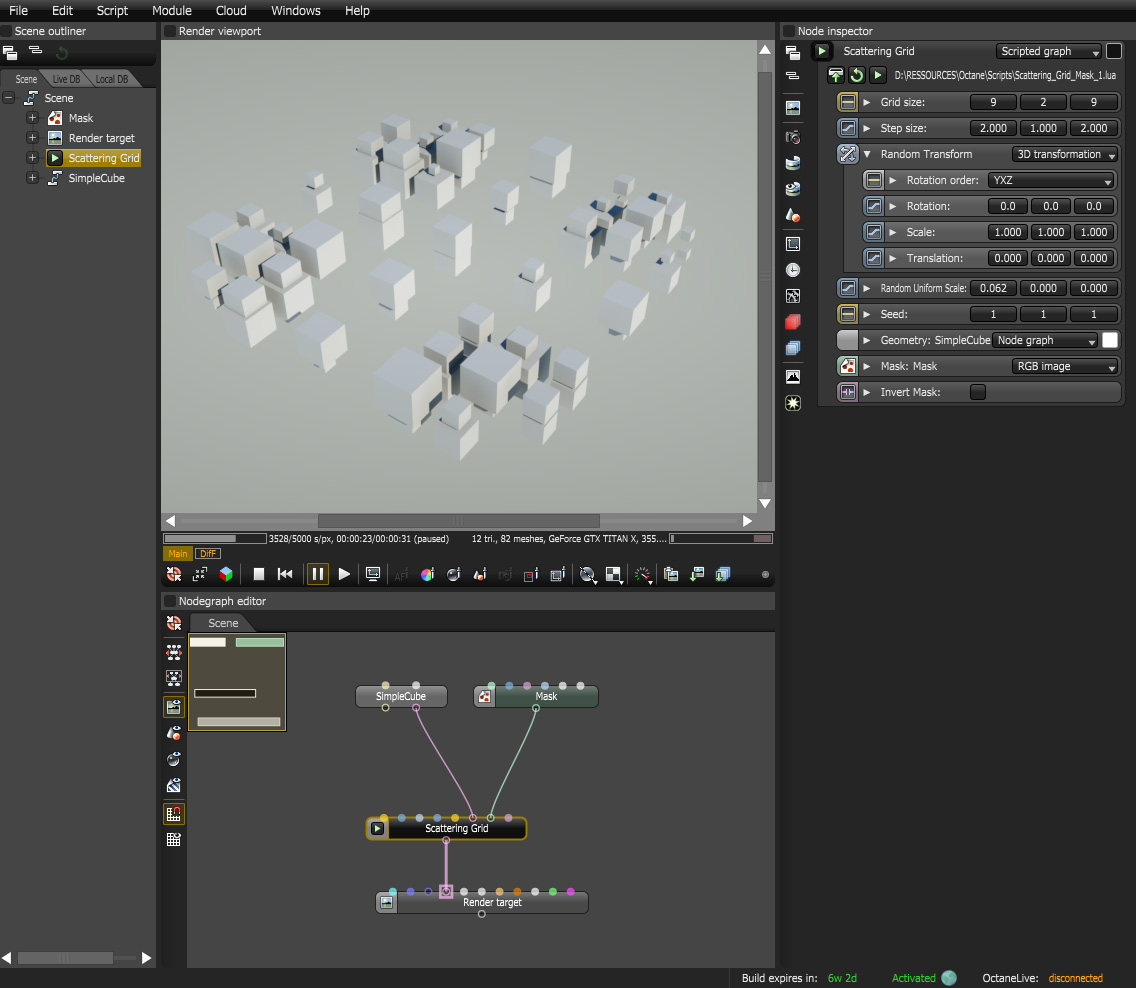

Hello!
This is my first humble script!
Since I'm struggling to develop it I decided to post it a W.I.P here with the hope that other people will help me improve it.
This script graph is based on a simple grid scatter I found somewhere in this forum. I decided to take it and see how we can go further with adding random transformation on it.
The node will take as input the object and create a grid out of it. You can control the number of steps on X, Y and Z axis as well as the distance between them.
There is also a 3D transform input that is used to randomize the grid (rotation, scale, translation).
You can also find a uniform random scale parameter (only the first value work)
The thing that can be improve is the masking option.
At the moment you can plug a black and white map that will be used to turn off the visibility of the object according to the values of the pixels.
In the example above a map is used to create this pattern.
However, the technique to do that is very rough. I'm directly reading the buffer of the image.
My next goal would be to be able to read whatever texture input there is in this "Mask input".
Like this we could use all sort of nodes and transforms to create or modify the masking.
This is where I'm struggling and I would really appreciate some help on that.
I have different ideas of how to continue to improve this script after that.
It would be interesting, for instance, to be able to input a height map. Once I understand how to read texture input properly it shouldn't be too difficult.
The next step after that could be to have another object input, and be able to scatter out object on top of another object. In order to do that I believe it's possible to read the world position of the vertices, so in theory we should be able to find the position of some random point in between these vertices?
It would also be nice to be able to have multiples input objects and to randomly pick them to populate our grid...
We could also have an lua script to paint maps? ^^ I believe I'm stretching the dream a bit too far from my poor skills..
Anyway I hope in the current state it can be helpful for you and please reach out to me if you have any suggestion on how to improve this. I'm slowly learning.
Thanks!

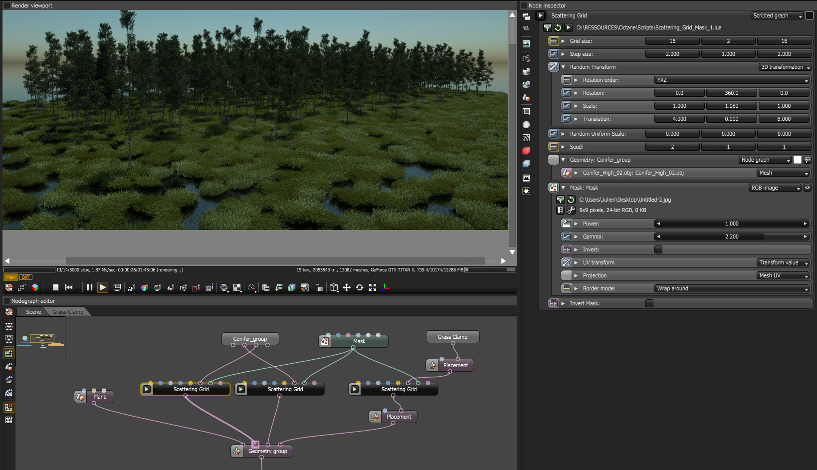

Well, you can do this already.
You need to set the second grid size parameter to 1to scatter your object only on a 2D grid.
Then you change the Random Transformation input to add random translation, rotation and scale if you want, then you can create a forest (see image attached)
This example have been made pretty quickly for demonstration purposes. Please don't judge the render ^^
I've combined different scattering. 2 Trees and 1 clamp of grass. I used an image to breakup a bit the scattering and added random tranform on everything.
To get better I should add instance color variation on my models.
Cheers!

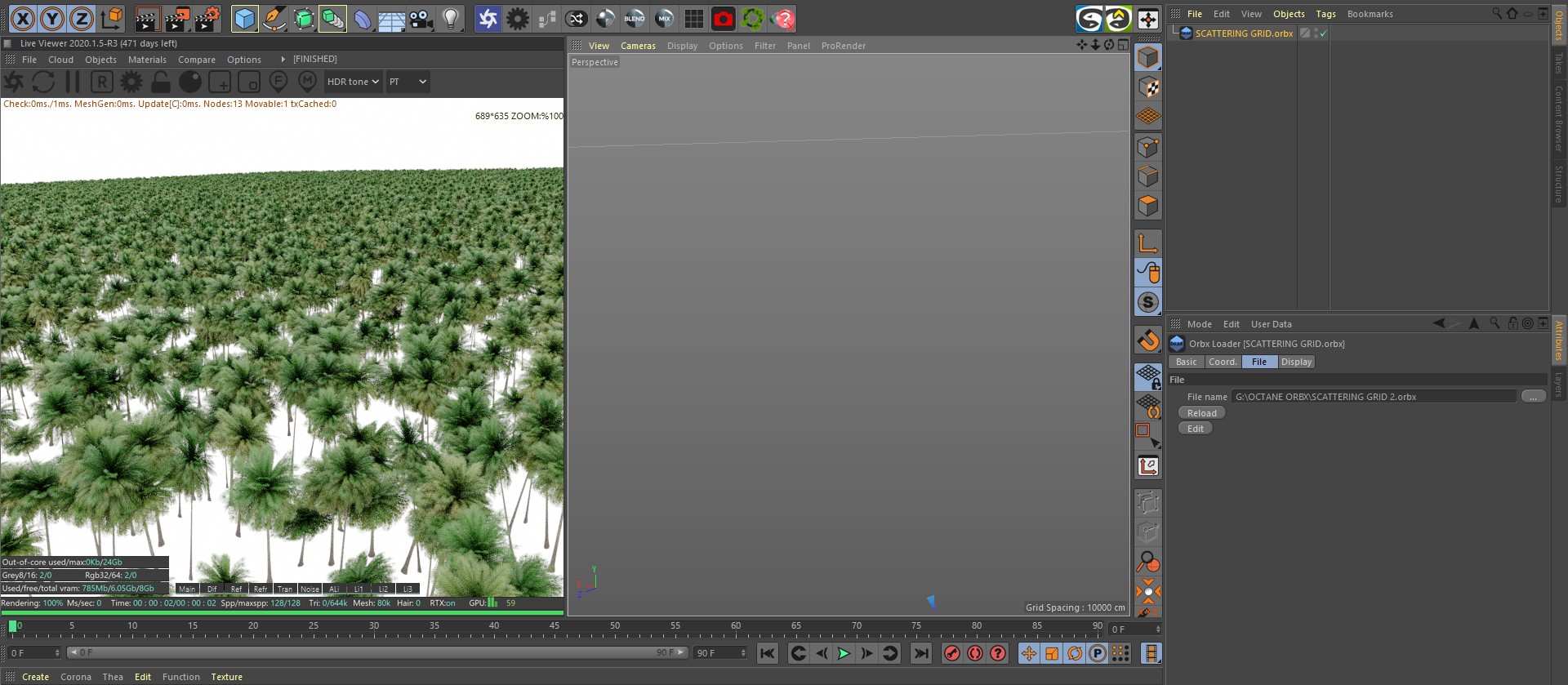

I really hope Octane 2020.2's new Scatter node works as stable as this solution. This is really killer stable. Is a pitty we can't impove it into a full scattering solution.
I imported a Standalone scene wich contained a grid with 200 x 200 scatter Palm grid into C4d.... it is amazingly stable. I can't expect anything lesser than this for 2020.2.
