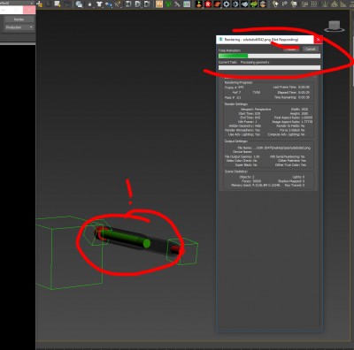

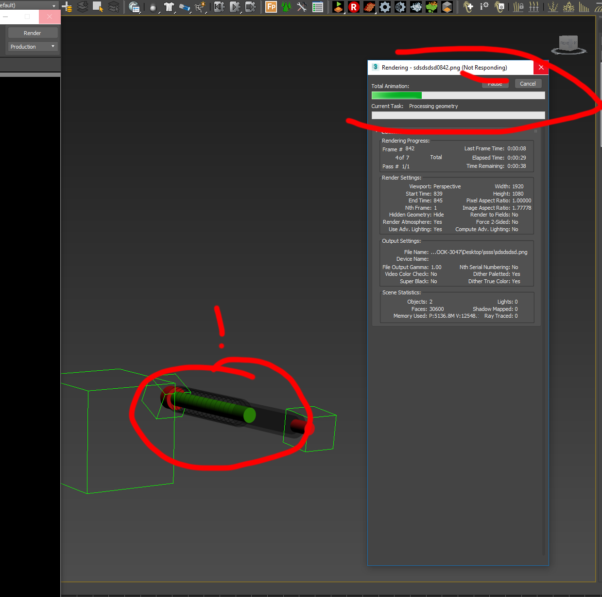

If you render the scene animation in about 4-5 frames or more 3ds max (2018.4) will freeze at processing geometry. This problem for some reason is caused by 3ds max damper object. Never had this problem with octane 3
the scene is attached
UPDATE:
damper causes stuck at processing geometry and some other meshes. Not sure which ones
3ds max damper object causes octane 4 freeze

Hi coilbook,coilbook wrote:Hi
UPDATE:
no issue using damper, could you share your damper sim?

Hi Paride,paride4331 wrote:Hi coilbook,coilbook wrote:Hi
UPDATE:
Regards
paride
that is strange when I render this damper (just damper, there is no sim data) my 3ds max would get stuck at processing after 5 frames or so using RC2 build. I am also using 2018.4 max. Maybe something on my side

Hi coilbook,
Thank you for the scene. I could reproduce the problem, even on max 2019, so it's not on your side..
It seems to come from the motion blur with those damper objects.
When motion blur disabled, there is no problem...
We are investigating in more detail, and will try to have a fix soon.
Thanks !
Thanks !
