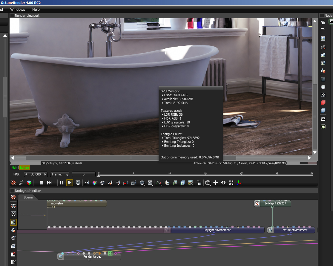

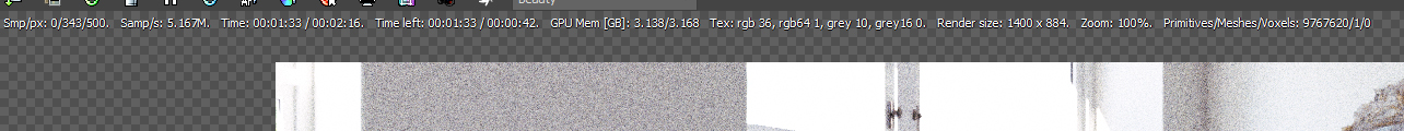

Well I never had ANY issue before and finger crossed is not any problems with my cards but errors are about memory not available for denoise when the same scene on SA does work although it takes 3-4 seconds to switch between Beauty and Denoise pass back and forth and I don't remember this issue neither.
my hardware is what you see in my spec so it is correct, Only One monitor Samsung S24 D300 Kernel and devices hereunder and Parallel samples is from the screenshot 32
bear in mind that I did build the scene heavily as I have a 3d scan ( see number of primitives in the SA screenshot ) and it seems to be the culprit BUT why is the SA working and the same Core on 3ds isn't?https://render.otoy.com/forum/viewtopic.php?f=80&t=68576&p=344676#p344676
last : Scene evaluation takes up to 60 seconds for this scene to start render, while on SA it takes about 27 seconds..
a bit lost..
edit: It has to do with the number of Poligons in the scene BUT having 3GB left as shown can't see why the stutter and gpu fail...
Same scene exported in SA, it work, although it takes good seconds to denoise
Scene Memory and number of meshes( about 9 millions cause of the 3D scan ) 3dsmax
Kernel and device settings

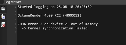

Denoiser still crash 3ds max on large images (4500x4500px).
It doesn't matter what card I put for denoiser (980Ti, 1080 or 1080Ti)
If I put for render 980Ti (2 monitors) +1080 and scene is 1,5 Gb of Vram.
And 1080Ti I put only for denoising. And it is not enough 10 Gb of Vram to denoise image of 4500x4500px?
3ds Max just chat en in log I get this:

ramone163 wrote:Denoiser still crash 3ds max on large images (4500x4500px).
It crash on my 3gb scene too ( as the previous release ) and I have 3GB left. try the same scene on the Standalone...

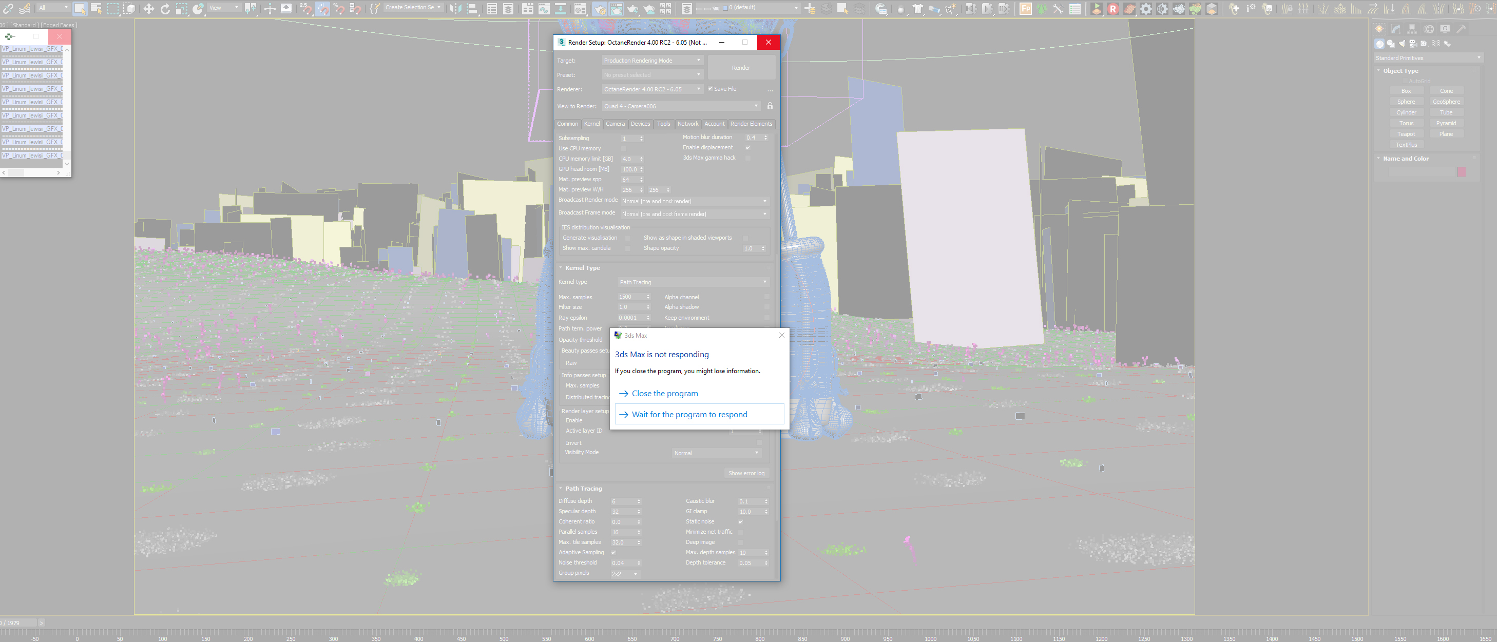

this build would render 50 frames or so then stop and max becomes unresponsive. Noway to even click log button what happened
using 2018.4 and raytracing kernel. no errors on slaves. maybe due to autosave during rendering or denoising stage not sure.
UPDATE: it gets stuck at processing geometry
