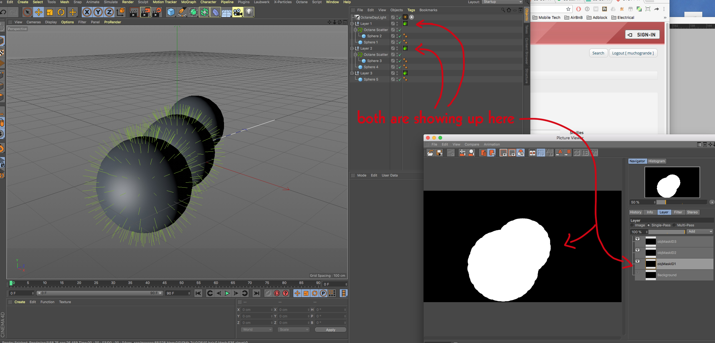

Hey, I'm trying render out Layer Masks in a scene utilizing a bunch of Octane Scatters and hit an issue. I made a test scene with 2 scatters set to 2 different layers, but both are being rendered in the objMask for Layer 1. Screenshot doesn't show it but I did set each Octane Object Tab to a different layer. (I also tried putting extra tags on the actual scatter objects but to no avail). Am I missing something here?

Put tag to cloned objects.
