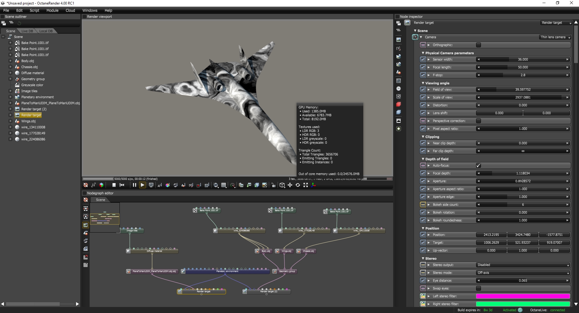

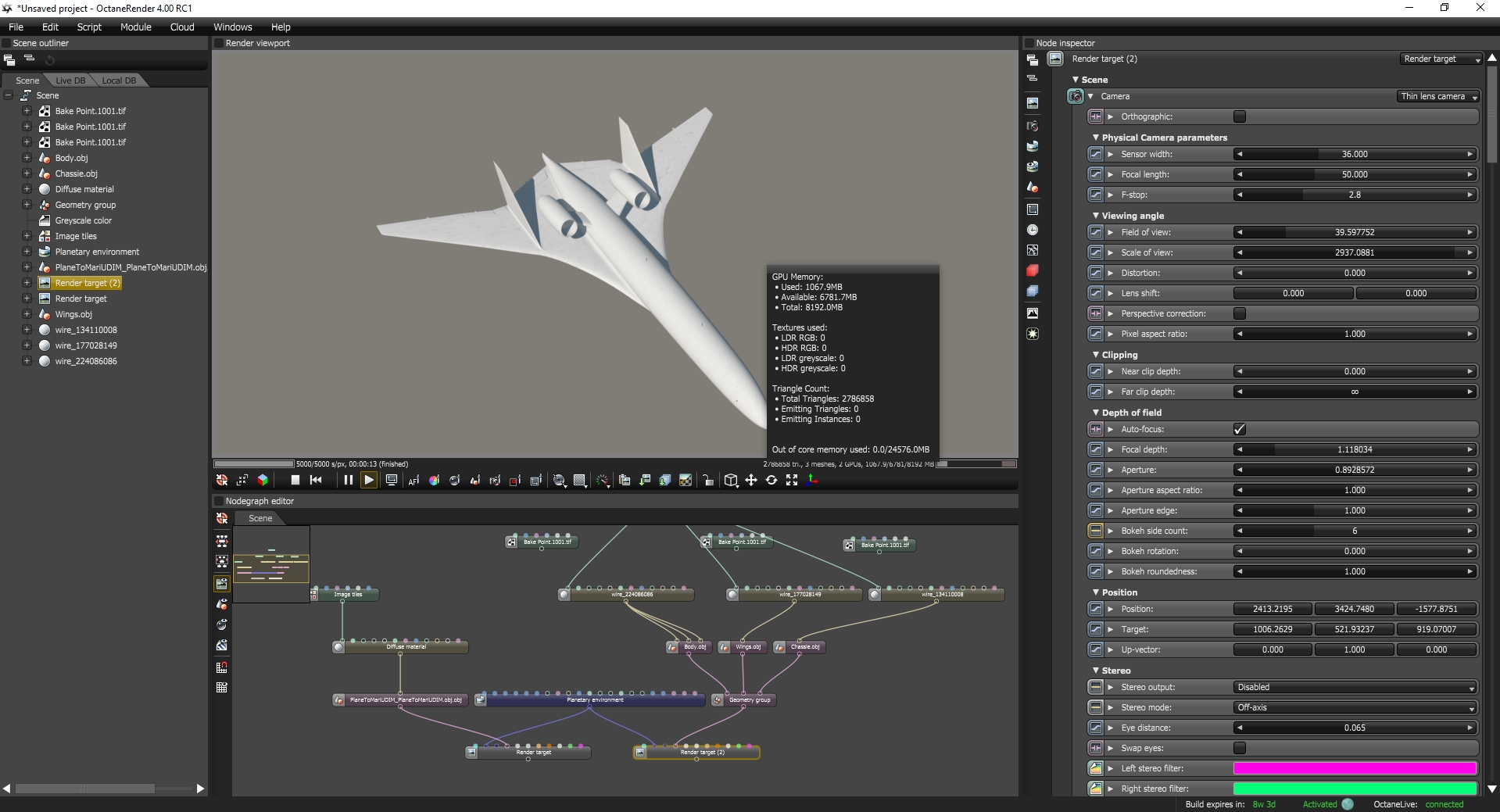

Hi Octane Team,
Thank you for the new release!
In previous release was introduced a new node "Image tiles" which allows us to use UDIM workflow inside Octane
I asked a question in XB4 release thread about is there any performance difference using Image tiles or just regular Greyscale textures. Cause this problem was in original OSL script which Roland wrote, that OSL recognize any image as a color, even if it is greyscale
And Roland replied in that thread - There is no difference in VRAM consumption
But I did some test and as we can see there is a HUGE difference in VRAM usage.
In my example there is 3 textures in 4k resolution applied to a model:
1) Without any textures, only greyscale color applied to the diffuse input, VRAM usage - 1067MB
2) With regular textures applied, VRAM usage - 1115MB
3) With Image tiles texture applied, VRAM usage - 1385MB
I've attached screenshots
So do a simple math we can say:
Regular textures eat 48MB of GPU Memory
Image tiles eats 318MB of GPU Memory
Which is INSANE difference in performance! And this are only 3 textures in 4k, I can imagine what a difference would be if I use 10 textures in 8k resolution
I think you should definitely fix this issue, maybe add switch "Greyscale"/"Color" inside Image tiles node
Cheers

SergKlyosov wrote:Hi Octane Team,
Probably those images are saved in RGB or RGBA format, and Octane will keep that source format. We'll add a field to explicitly choose how to load the image files.
--Roeland
--Roeland
Hi Roeland,
Thank you for the quick reply. Sounds good
Also thanks for new automatic placeholders in Image Tiles, now files from MARI hook up without effort
Cheers
