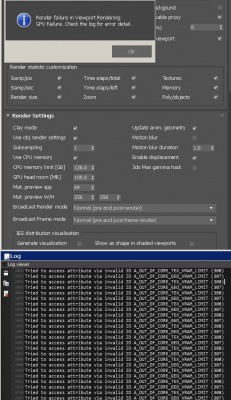

Trying to set some scene in V4, because in V3 its not possible because of the out of core limit.
Its a pretty large scene with about 25 UDIMs and displacements and such
After a while I ran into this error:
Render failure in Viewport Rendering: GPU Failure
this is from the log:
Tried to access attribute via invalid ID A_OUT_OF_CORE_TEX_VRAM_LIMIT
Tried to access attribute via invalid ID A_OUT_OF_CORE_GEO_VRAM_LIMIT
Seems like there still is some out of core limit, or not?
screenshot in attachment, anyone know what this may be?
