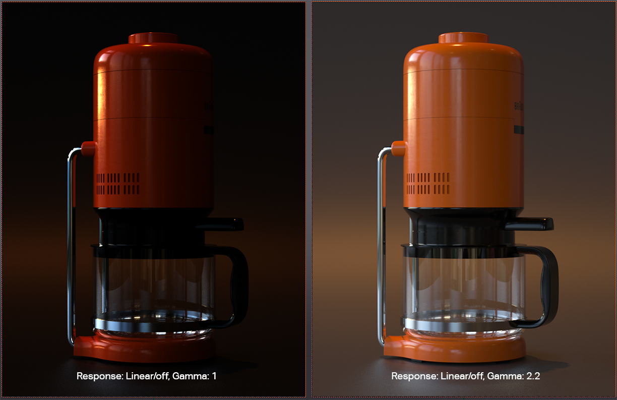

aufwind wrote: ...The Gamma Value in the Camera Settings for Linear should be set to 1 (when Octane Camera Imager is enabled)....
With response type of Linear the Gamma must be set to 2.2 otherwise it's oversaturated and has too much contrast and is too dark.

AndreasResch
Posts: 78
Joined: Wed Jul 25, 2018 4:53 pm
I thought so. That's what the majority suggested.
