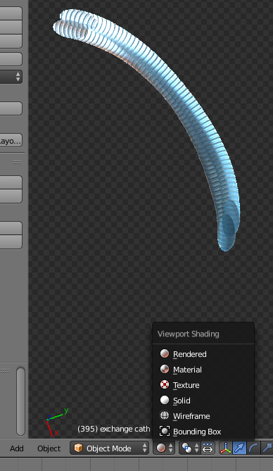

Hello,
The attached show near plane clipping I am getting when zooming in when in the 3d view, Rendered mode.
Is there an adjustment for this? The actual Render seems to work fine ( not clipping).
Thank you,
Rick

Press N key to show right panel with options. You will find clipping settings there.

Hey, Rick.
This is a bug at the moment if you're in orthographic view. I've already reported it. When you're in orthographic view, clipping settings are ignored. It does not matter what you enter in the clipping settings. These settings only apply in camera and perspective view.
Cheerio,
Andreas
