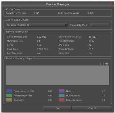

jershaun wrote:OK. I've tried everything and I don't know what else to do. See below for the info on the graphics card (saved directly from the control panel dialogue box). Any other ideas?

I have the same Graphic Card as you and everything seam to be OK here. But I did notice a different in the CUDA Version. As in my NVIDIA System Information It say that I have the "NVIDIA CUDA 2.3 driver" however the Octane Render Device Manager show my is a "CUDA Driver Version 2.03". I did notice the different in your also. See my Info below.

thanks bobbytaylor
after installing drivers as mentioned by others, my cuda version behavior is the same as yours.
I still don't know whats going on.
I'll try and get myself another system and try Octane.
Thanks,
Thanks,
Jershaun
