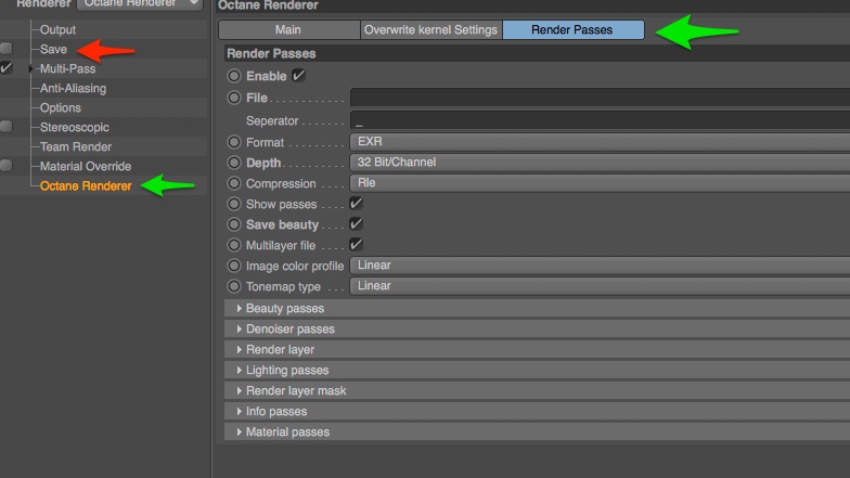

Is it possible to batch render multi-pass EXR sequences in Cinema4d?
when I add to the render queue it just renders TIFF files into the folder where my C4D project file is.
The line to see the destination of the Multi-Pass file location is greyed out.
THANKS!!!! :D

Yes it's possible, just make sure you set it up in the Octane Renderer > Render Passes section, and not the Save section.

I have that set up already with multipass checked and save unchecked. But when I add that render to the queue it only renders TIFFs to the folder where my C4D file is located. And does not render the EXRs to the location I specified in "RENDER PASSES" within "OCTANE RENDER".

http://www.aoktar.com/octane/RENDERPASSES.html
Be sure that you give save path in Octane->render passes and don't use C4D's render passes.
