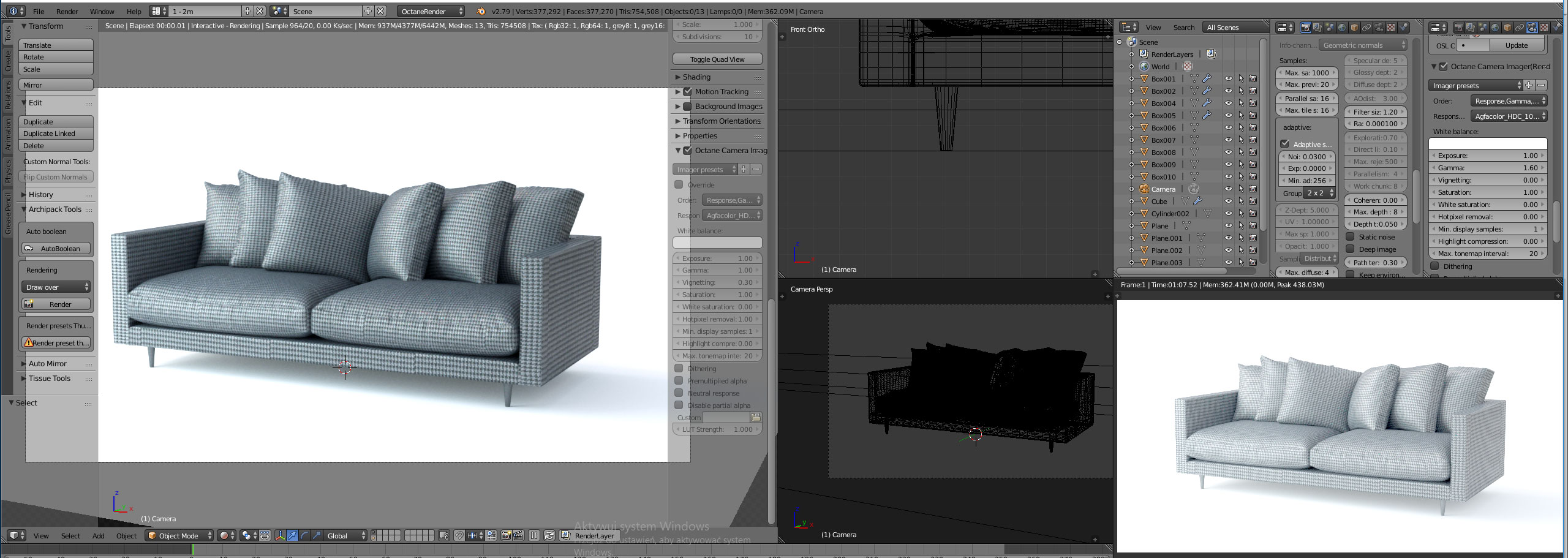

same question here, 15.2.5 why render is VERY different from preview? i have thicked octane imager i have thicked imager in the view panel (thanks JC i had no idea that they chaneged it this way, very ackward by the way) but rendered image is different from what i see in the previev .... what can be the problem ?

To fix the difference between live preview and final render you need to go to Blender's colour management options and set the Display Device to none. Leave exposure and gamma at Blender's defaults and don't forget to turn on "Octane Imager" check box in camera settings.

Thanks JC :) You are doing a lot of great work around here :)
