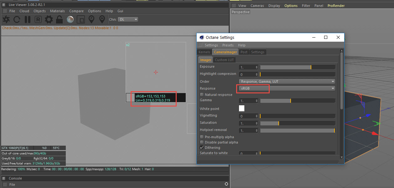

WIP but my image seems to come out blue
Environment lighting or camera imager. Check those!
Yeah, I wouldn't worry about the cause of it so much as how to fix.
To fix, just change the white point in Camera Imager:
More blue whitepoint in camera Imager = redder image
More red whitepoint in camera imager = bluer image
So, you can quite creatively mod the color to find the grey you are looking for.
