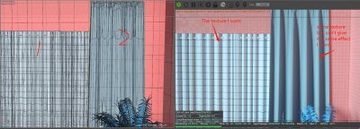

I'm made a curtain and then decided to change it to another mesh. However no matter how I adjusted the texture transform and projection, just couldn't get the same result as before :(
How can I solve the problem?

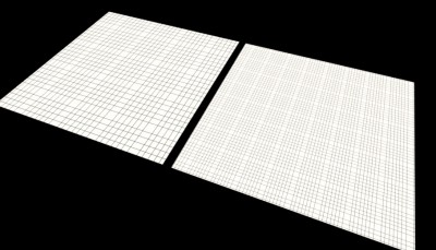

Are the UVs for curtain 2 scaled differently that curtain 1?

yes, it's different. Curtain 2 has a more complicated UV and is subdivided.

Try scaling them down, so that the texture scales up in relation.
This is the same texture, and same number of Polys, but the UVs on the right are scaled up
If you're still having trouble, upload a simple scene.

Thank you for your response! Really saved me.And I changed c4d texture tag projection mode to cubic. Problem solved!
