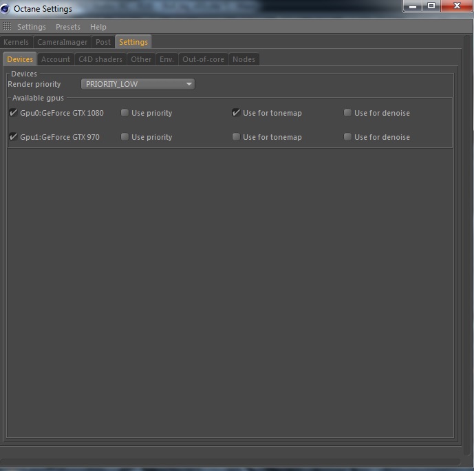

niestudio wrote:@max1e,
can you post a screenshot of your Octane settings > Settings > Devices tab?
in attach. of course i test with single 1080, with single 970 (before posting here), and together variant on video.
niestudio
Posts: 265
Joined: Fri Aug 21, 2015 10:03 pm
Does it help if you tick use priority on the card that has your monitor(s) connected to it?

Posts: 10611
Hi max1e,
sorry, I’m not an AE user, do I really don’t understand your ‘video-question’.
Please, note that 970 has only 3.5GB of VRAM, even less under Win 10, if you use both GPUs, the available VRAM is limited to ~3GB, and if you work in the same time with AE, the available VRAM is even less.
If you want to work with both AE and c4doctane at the same time, try this setup:
  • connect 970 to display so it will be used also for system/OpenGL, and use it also with AE and all the other applications, Photoshop, Chrome ecc. (you can define this in the Nvidia control panel)
  • use the 1080 with c4doctane - CUDA rendering only to have the maximum available VRAM
In this way, you should be able to work with both applications, with better stability.
ciao beppe
*edit: in v4 you can also use 970 for AI Denoising, and 1080 for rendering only.
