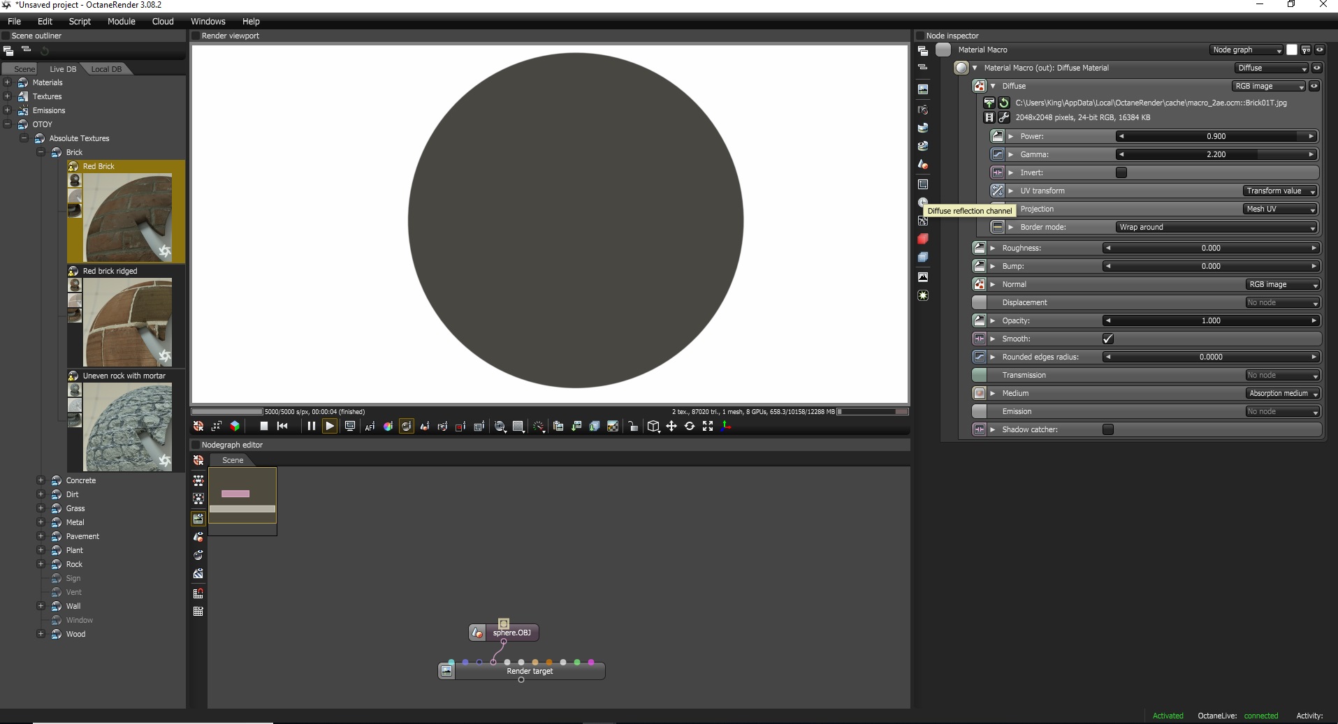

Okay, please someone tell me if they ever saw this before, or if they know what is going on.
For me, EVERY texture is loading as a solid color now, on every version of Octane.... :o
(tried in XB3, XB2, and now V3.08. Same.
This is a LIve DB texture, also coming in as solid.
I guess this explains why the opacity map was blocking out the whole diffuse in the other scene. But what the heck!
Mobo: 1 Titan RTX, 1 Titan Xp
Plugs: Enterprise

Notiusweb wrote:Okay, please someone tell me if they ever saw this before, or if they know what is going on.
There sphere probably doesnt have UVs
Thank you Funk.
You know what, I think you are onto something here. Not every geometry I am going back and testing is experiencing this issue.
But the ones that do, texture maps do not work consistently. Not diffuse, not opacity, etc.
Would there be any way around this? or is it that some geometries just are not going to play nice with Octane as they have no UVs?
I am open to any suggestions :oops: .

Notiusweb
Posts: 1285
I was able to 'reconstruct' a faux-UV by using the UV Projection, setting to Box, and then using the Texture rotation/resizing/coordinate settings. PIA, but it actually can work.
Thank you again, Funk.
