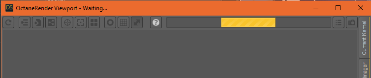

I'm thinking of buying this plugin and I'm using the latest demo version (OctaneRender_for_DazStudio_3_8_0_38_Win64_DEMO) to test it with Daz studio 4.9 64bit.
I found a strange behaviours that I cannot believe is normal, as nobody would be able to work with this plugin, so need help to figure out what I'm dong wrong.
I also own the Carrara plugin, so know a little bit about Octane.
I create a new scene, place any object, e.g. Victoria 5, I open Octane viewport and render.
It renders fine.
I save the scene, then I load the scene again from disk.
I open the Octane viewport and it just hangs rendering, the yellow bar moving left and right without doing anything.
CPU/GPU not busy.
This happens always.
In other words: You cannot reload any scene with the demo version.
Reloading scene in the demo version impossible

I updated Daz Studio to latest version 3.10 and can still reproduce this major problem.

So, to reproduce.
Use latest Daz Studio and Octane plugin
1- File->New
2- Create->New Primitive
3- Save
4- F12->Open Viewport
5- Octane renders scene as expected
6- Close viewport
7- Exit Daz Studio
8- Start Daz Studio
9- Load Saved Scene
10- F12->Open Viewport
11- Octane is stuck and never finishes rendering
There is no kernel node when you reload the scene, so the Octane data is incomplete and the scene will not render.
Paul
Paul

hm, unfortunately that was not it. I bought the license and it behaves exactly the same. I cannot render a scene that was saved and reloaded.

OK, figured it out.
Any scene saved with the demo version cannot be reloaded and rendered any-more.
The licensed plugin can save and reload.
@Paul: I strongly suggest to document this in the download page of the demo version, as it is not documented and this is a very big limitation.
