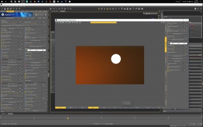

I know this has been asked before .. but back in 2016. I need a more current answer.
I'm trying to animate a movement of a simple object past a camera and I want a decent motion blur .. one of the prime reasons for me buying Octane was the inclusion of Motion Blur. However after several test renders there is still no motion blur to be seen. The animation is fairly smooth but looking at the stills it's clear the object is in perfect focus.
I thought it would be shutter speed that makes the difference but setting it to as low as 1/15th still didn't produce motion blur. I have set both objects and camera to motion blur in the hopes that I'd see something .... nothing.
So what gives .. what haven't I done. Or is Motion Blur in Octane for DAZ one of those things we'd all love to have .. but it's still not available yet?
Please let me know cuz I REALLY want to be able to use this.
UPDATE:
I have just been playing around with Viewport and I noticed that in the SFX tab that the Object Motion blur is greyed out? Is perhaps THIS what is causing the problem. If so .. how do I get that to work?

The easiest way to handle motion blur is to export the animation to ORBX and load that export file into Octane Standalone, where you can control the shutter speed, etc.

I tried that but it didn't seem to export any animation .. it just exported a still scene. Does motion blur not work at all in the plugin?

Can you post a screenshot showing how you exported the animation pls?I tried that but it didn't seem to export any animation .. it just exported a still scene. Does motion blur not work at all in the plugin?

Well a screen shot might not tell you anything that a bit of text wouldn't do better. Basically on the System tab I used "Export Complete scene". I've tried this as all three file stypes. The first type (I can't recall it's name right now) ... OCS .. and ABC.
Getting them into the standlone thing I find I have no clue what the hell to do to get this to even show me an image. I've tried to look up tutorial videos for using Octane Standalone but they all seem to be for much older versions. The OCS imported something that had a frame count .. but just a grey screen?!?
ABC did nothing that I can discern .. and the first file type made an import of a still scene .. no frame count .. but only rendered something in the viewer port after I had a clicking fit just trying to get it to do something .. ANYTHING!!
I gotta say the Standalone app is not very intuitive and there's next to no help that I can find in trying to use it. The plugin works MUCH better for me because I can actually see a result .. affect changes etc, and make an export. Sure DAZ and Octane crash all of the time so I've learned to hit 'save file' after making any change.

I would suggest reading the Octane Standalone manual (https://docs.otoy.com/StandaloneH_DEV/S ... Manual.htm) and there are a lot of videos at https://docs.otoy.com/Portal/Videos_Standalone.htm.
It is also worth reading the plugin release notes at viewtopic.php?f=44&t=55214
Paul
So click the Alembic Export button, and save to an ABC file - and a wrapper .OCS file will also be created in the same folder, which you can load into Octane Standalone.3.0.15.21 (21-May-2016)
- Compiled with Octane 3 beta 4 (3.0.15).
- Animation motion blur is now working again. Use the current camera Motion Blur and Shutter Speed parameters to set this up. WARNING: Both these parameters can be animated, so make sure you go to frame 0 to set these up for the entire animation sequence. The plugin does NOT pickup the FPS from the DAZStudio Timeline - so you should set DAZStudio to Octane's default fps of 24.0 fps. Motion blur is also working when exporting to OCS via System->Alembic Export
Paul
