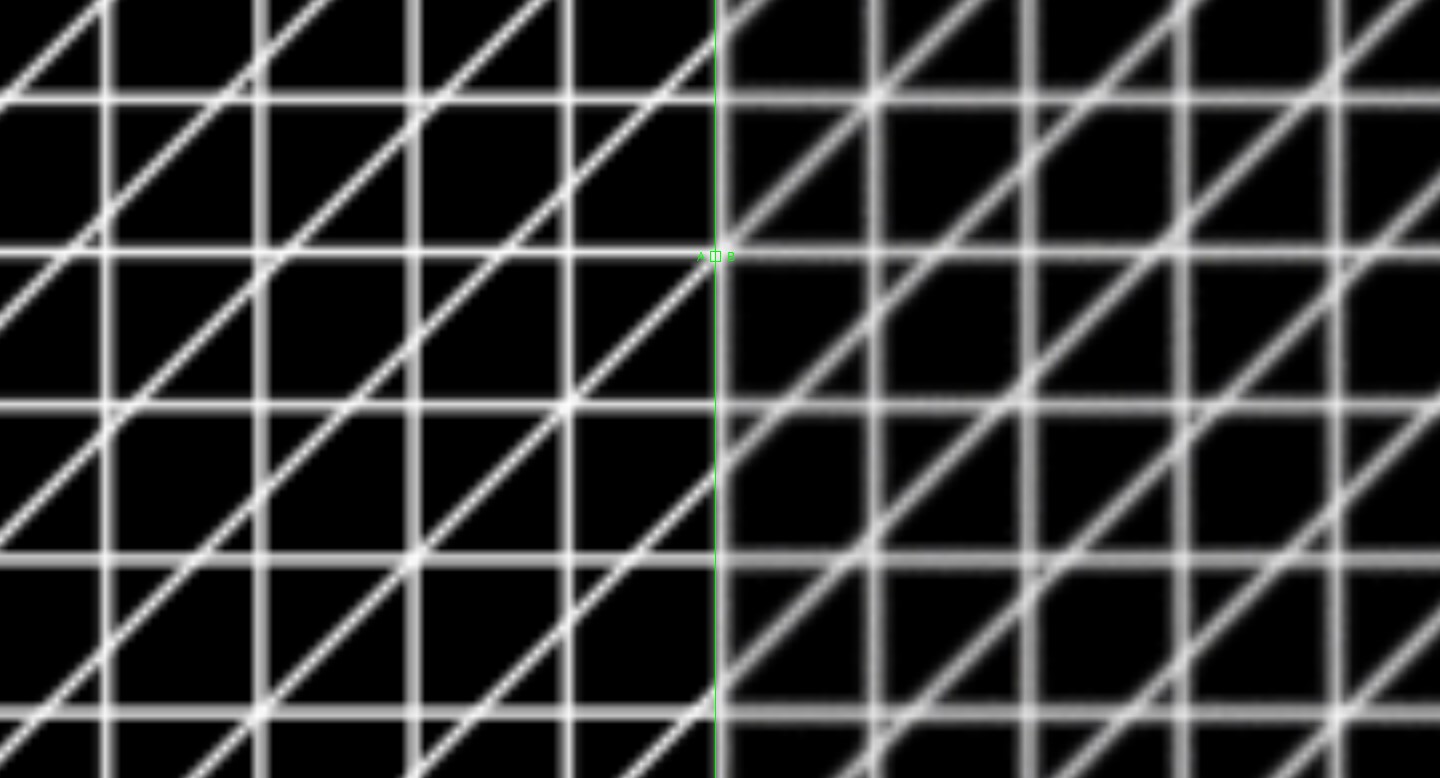

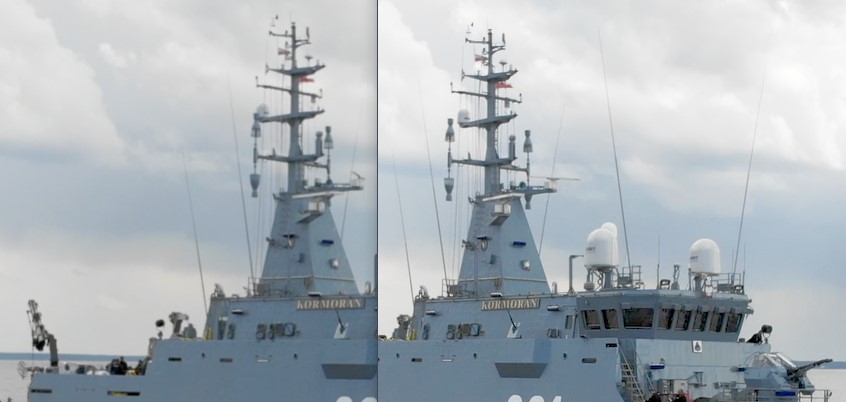

It appears, rendered images are not as sharp as base textures.
It has been posted on this forum several times but never with an explanation from devs.
Here are two examples.
Filter size: 1.0
no DoF
image is a png16 file from Image Texture node.
Comparison is made between the texture and the rendered plane with this texture applied.
Camera has been tweaked to leave zero distortion.
Is there any solution to this? Or any explanation?

As far as I know, the only way you are going to get a 1:1 perfect texture is by using a Background Object or equivalent. No matter what, your 2D textures applied to objects in 3D space are going through an insanely complex set of samplings and transformations including all the algorithms describing the interaction of light with a surface, a lens, etc, before being sampled back down to 2D. There is going to be resampling and image quality loss. The old rule of thumb I still use is that a texture should be at least 1.5x the resolution you expect to see it rendered on screen. Even better, 2x.

I made a test with 2X texture and it looks better, but still is slightly blurry.

There's no mystery here. Resolution of textures in Octane is perfectly fine. Texture filtering is absolutely necessary in computer graphics and it's partly the reason why your textures seem smoother.
Think of your textures as 3D models, not as images. If you want to see 'pixel for pixel' accuracy you would have to model the pixels. Trivial thing to do in OSL.
A 5 min. search led me to this cool OSL shader. I adapted it and... voila:
You could get the resolution from the texture map automatically and use the code above for UVs. I've no time to put this together now but why should I even bother, you don't seem to care about any of this since I'm not a core developer. Why am I even wasting my god damn time here? :roll:

I should have mentioned that everything that frankmci said still stands and I agree with that. So for sharpest (1:1) results you'll also have to adjust filter in the Camera Imager to minimum. It's just almost theoretically impossible (IMHO) to have the size of pixels in the textures to always perfectly mach the size of pixels in the render with all of the perspective projection, dof, antialiasing and 'RGB-to-spectral-and-back' calculations. Uprezing textures is still a superior method. The lower the resolution of your textures, the more they will be affected by texture filtering. Hopefully, you'll be able to see that for yourself with that OSL node.
Correction: Having textures with resolution higher than the final render resolution is a superior method. Upscaling textures with low resolution will just blur them out even more.
