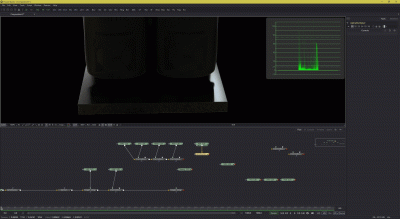

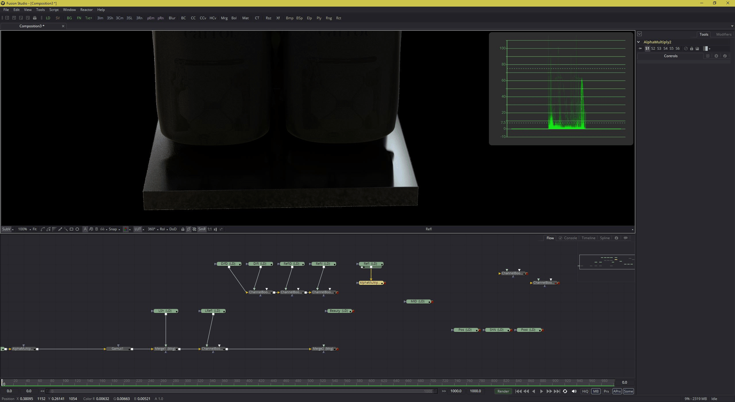

It's not just lights for me. After hours of rendering and saving out passes, I noticed the alpha channel was aliased while trying to do a back-to-beauty composite in Fusion. This is bad!
The alpha channel in exr will not be anti-aliased whether or not you multiply the color channels with it (by checking the pre-multiplied alpha checkbox in the Imager). This is true for all beauty passes I tried. Not true for info passes.
The work-around while they fix this is to take the alpha from an info pass and transfer that over to the beauty (in a compositing package).
