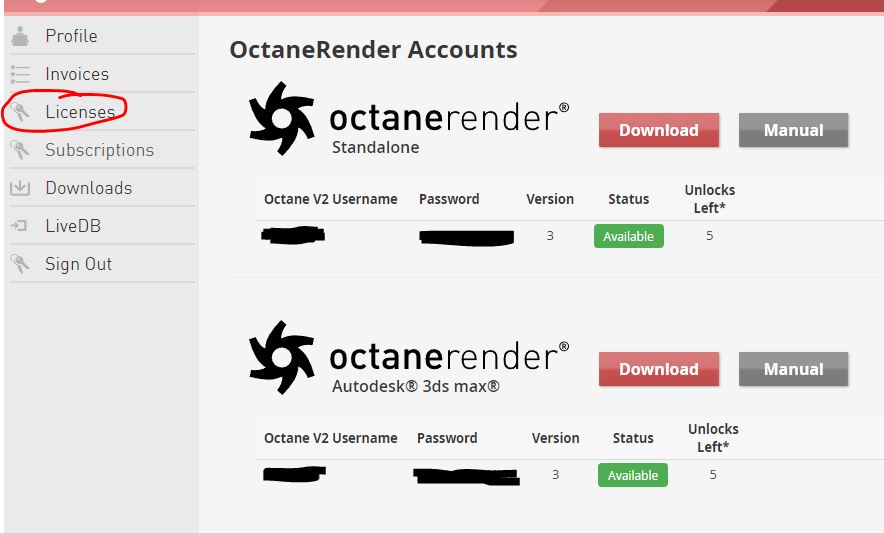

Hold up, my account has a v3 licence for 3DS, not a subscription, so it should work right?
paride4331
Posts: 3895
Hi Critters,
I can not say what license you have, but you can know it by looking at the screenshot.
Regards
Paride
Critters
Posts: 13
Joined: Mon Oct 24, 2016 2:39 am
Here you go
paride4331
Posts: 3895
Hi Critters,
To use the plugin’s network rendering feature, you need the Standalone Edition’s slave node installed on each of the external computers, so you need to purchase a single Octane license for your slave.
https://docs.otoy.com/3DSMaxH/3DSMaxPlu ... dering.htm
Regards
Paride
