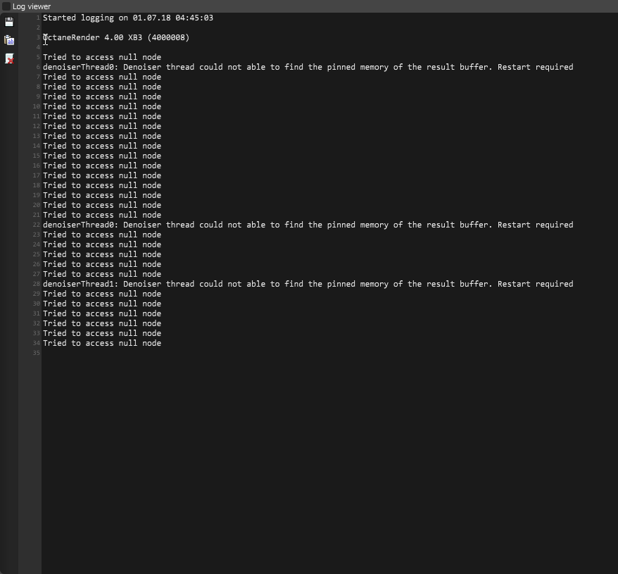

Hi, i get a render failure in live viewer after denoiser. See image.
Btw, denoiser is making my image brighter.
Also insta crash when adding multicloner.
edit: also cant render sequence at all with R18, see my post at latest stable too plz. Here doesnt crash yet* just freezes on first frame seems to load forever

thanulee wrote:Hi, i get a render failure in live viewer after denoiser. See image.
It has crashes with multicloner. I'll add new fixed build soon.
You need to use tonemapped buffer for passes if you need denoised pass at same as LV. Don't forget that LV is tonemapped, passes are linear by default.

Thanks mate, im on it! keep up the good work!
