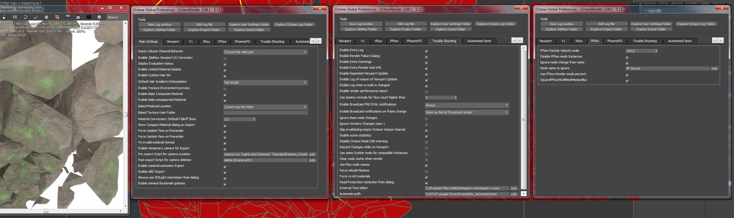

paride4331 wrote:Hi coilbook,coilbook wrote:Hi Paride
i have an object that gets destroyed. No matter what projection I use procedural texture moves and does not bake to the rock chunks . The texture does not move when the whole objects moves but when chunks move texture moves. Here is the link to the video. Object is treated as on piece by rayfire voronoi is it the reason?
Also can we have all procedural textures mapped to the objects by default so texture moves with the object no the other way around
Download link
https://wetransfer.com/downloads/6e6dae ... 227/062f22
it seems to work, you could check Octane Global Preferences options.
Regards
Paride
Hi Paridie,
so can you tell me what do I need to adjust so my single mesh that gets destroyed will have textures move with the object? Thanks
- paride4331
- Posts: 3989
coilbook wrote:paride4331 wrote:Hi coilbook,coilbook wrote:Hi Paride
Download link
Regards
Paride
Hi Paridie,
