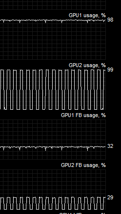

However, when I enable both graphics card on Octane render (so it renders animations faster while I'm sleeping!) this happens:
The second graphics card is not performing as it should :( Performance goes up and down...
This is on a moderately heavy scene (with SSS) However, it's worth mentioning that this never happens on the graphics card on top. In fact, I can render the same scene using the first GPU and everything works fine... But enabling the second GPU, which is a GTX1080Ti, (just like the one on top!) will cause this instability
