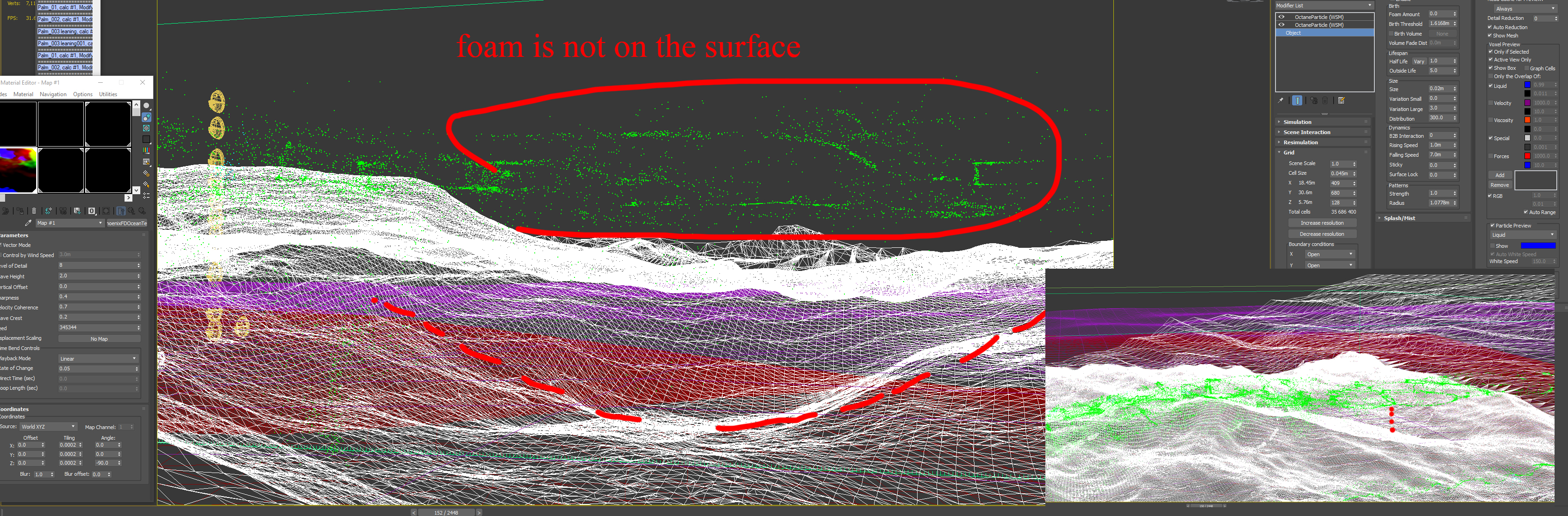

Hi HEre is the thread in chaos forum about the bug where foam is not displaced with ocean mesh. https://forums.chaosgroup.com/forum/pho ... he-surface
They told me it is octane problem. I thought it would be phoenix they said it is octane bug.
Please fix it. We cannot have high waves because foam is not displaced with the mesh. Hopefully this can be fixed soon.
when I have high waves 3 meters foam from the ship does not contour around ocean mesh. it stays above wave holes
This is what they said "The displacement is not affecting the foam and splashes in the viewport preview (it's in the to do list), but it's all good in the renders." I guess OCtane cannot recognize that foam must be displaced with the mesh and still renderers it like in a viewport

I will send you the scene soon. Foam work fine on top of liquid but when you use ocean texture with high waves that foam must match to ocean mesh waves from the texture. Vray does it during rendering octane does not THanks
coilbook
Posts: 3144
As you can see when you render foam is airborne and only matches blue liquid particles instead it must match actual mesh waves during rendering.
if you go to the ocean texture in your scene and set waves to 5-10 meters high you will see that foam is not displaced 5-10 meters but it should be during high waves all done during rendering . Instead foam is floating

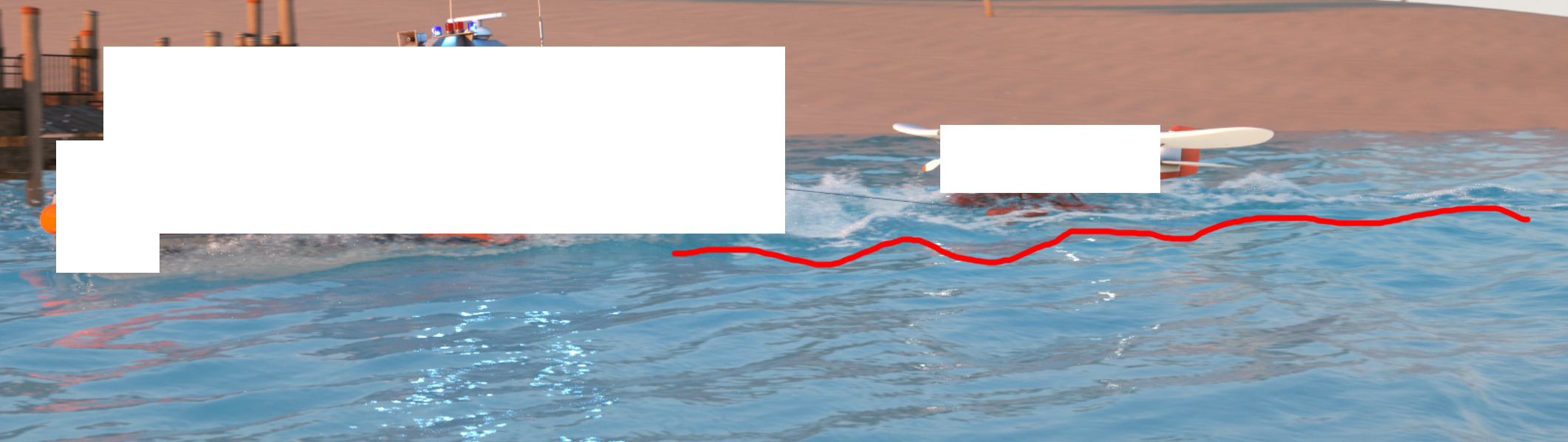

Hi Paride
here is another example After wave height was changed to 2 meters you can clearly see foam is stuck in the air and is not displaced with water mesh and still follows blue liquid particles instead . And this foam displacement is done using PHX foam shader This is a bug. Thanks
