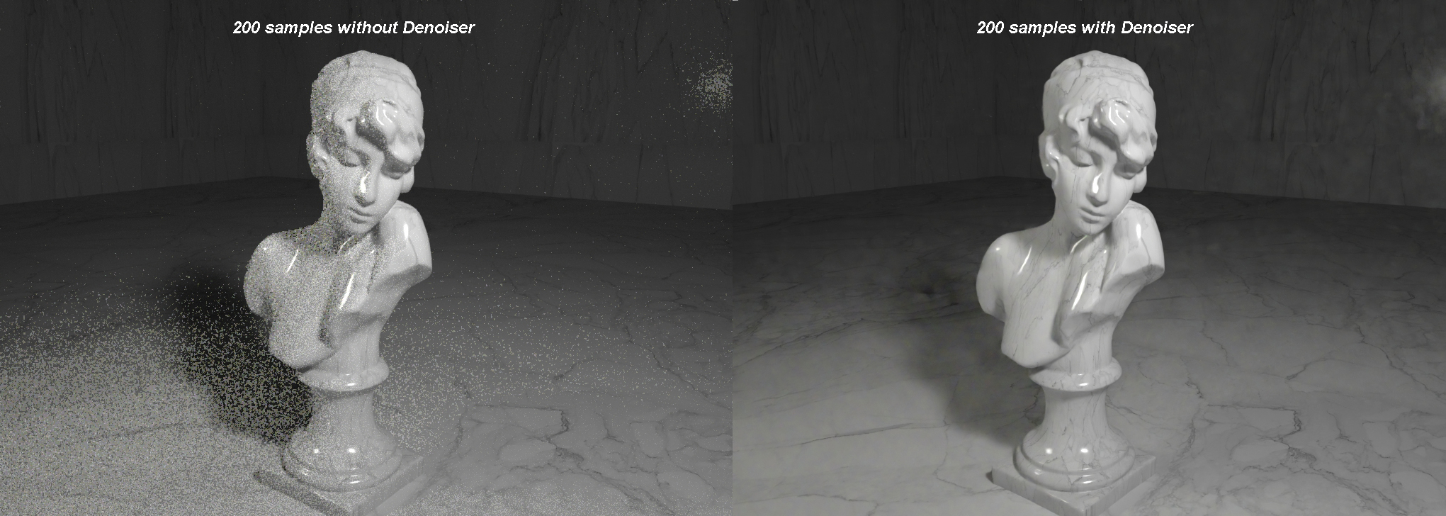

impressive!!! :shock:
100 samples
100 samples
200 samples
200 samples
