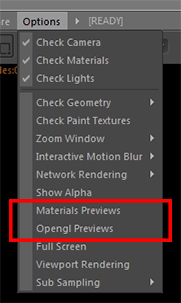

Ok guys I think Material Previews are to be blamed for CUDA errors. I had them disabled after working on a project and they were off while I was working on that scene with animated lights. After turning them on I can now see the same CUDA error after frame 5! Apologies for that. :oops:
Could you please try disabling both of these two options in Live Viewer before opening the scene and see if that fixes anything?
UPDATE: In the meantime, this issue was fixed in the latest 4.00 XB3 released a few hours ago! No more CUDA errors with material previews on here! That's our Ahmet ladies and gentlemen! In retrospect, these are uncharted territories, we're breaking new ground here in terms of how C4DOctane can be used so some turbulence was to be expected along our flight I guess. (and I'm probably the king of bad puns) ;)

milanm wrote: Could you please try disabling both of these two options in Live Viewer before opening the scene and see if that fixes anything?
Milan,
Yup, that fixed, or at least disabled the problem. I can now move past frame five and everything keeps working/rendering. I'll have to see if it's just been the previews causing my instability issues working with OSL/3.08.1 in C4D. Thanks for digging further into it!

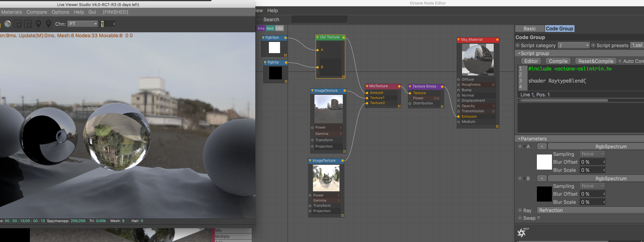

Here's a quick and dirty example of how Raytype can be used to switch between two different environment maps. Basically, that will allow you to use a different HDRI for refractions/reflections and even diffuse light.
When I experimented with this for the first time, I think I reached a point where I had about 5-6 different HDR maps for different things reflected or refracted in other things and, at that point, I completely lost track of what was reflected/refracted/visible where and what reflection is showing what diffuse HDRI... (taking a breath) So. Hopefully, that gives you an idea about the possibilities here...
Oh, did I mention that all of those maps can be fully procedurally generated OSL 'light studios'? Yup.
Usage:
Here Raytype OSL is used to control the 'Amount' value of MixTexture. Depending on what type of ray hits the Env. map, MixTexture will show one HDR map or the other.
Here's a quick demo.

It's too bad we can't see Environmental texture node networks in the Node Editor. Am I reading the youtube vid correctly, in that you are doing the equivalent of this? I've applied it as a full material to some geometry as a more tangible implementation of the Octane Sky object in hopes of getting a more intuitive understanding of what's going on.
Thanks again for sharing your experiments in OSL.

frankmci wrote:It's too bad we can't see Environmental texture node networks in the Node Editor
Amen to that. :roll:
Sorry about the headache! Yes, that's exactly the setup I used in the video, If we pretend that the purple emission node is the environment texture input, of course.
My setup is actually more complicated than it should be but I did it that way for three reasons:
  • To better show how this works in Live Viewer.
  • To show that, no matter how complex/simple the node setup is, it is just a click away once you save it in the content browser.
  • To show that complex setups can be used there instead of just HDR maps.
Edit: Using OSL directly instead of MixTexture should work (and it works just fine in the Standalone) but after doing some more testing, it seams there might be a corner case where it might cause a cuda crash in C4D so it's best to use the setup as it is in the video and the node graph in the post above.
Also, it would be interesting to try this setup on emissive geometry and combine that with light include/exclude in V4. I didn't test that yet but it should work in theory.
