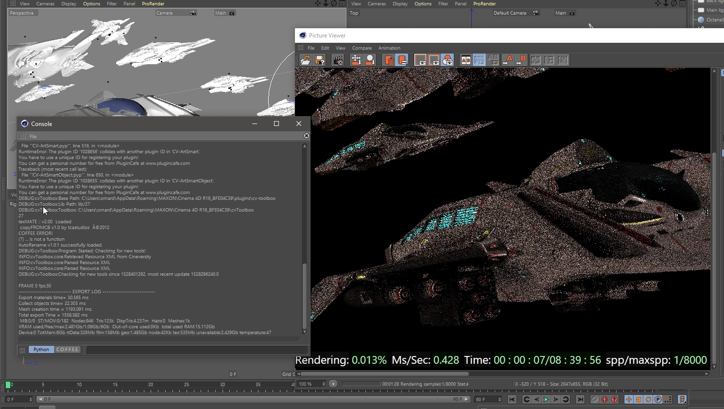

Greetings I have this bump that I cannot render to Picture Viewer an old v3.08 scene in this version (XB3 R1), Live viewer renders fine. the picture viewer stays at 0.013% in the octane lower status bar
Version XB2.1 (Test2) renders perfectly the same scene and all the passes without issue and without apparent visual differences.
Sadly I cannot share the scene, but I'm sharing screenshots from the Pv and the console in case any errors pops up
Any thoughts?
Thanks.

I think it's about a bug on gpu manager of plugin. It looks like stoped due don't have any gpu on rendering.omardex wrote:Greetings I have this bump that I cannot render to Picture Viewer an old v3.08 scene in this version (XB3 R1), Live viewer renders fine. the picture viewer stays at 0.013% in the octane lower status bar

I'm having this same issue. Just hangs after the first few samples are rendered. Renders fine in Live Viewer.omardex wrote:Greetings I have this bump that I cannot render to Picture Viewer an old v3.08 scene in this version (XB3 R1), Live viewer renders fine. the picture viewer stays at 0.013% in the octane lower status bar
Any thoughts?
Thanks.
I've made a quick fix for this issue. It was a problem on Windows version. Please re-download and install it again.agnes_io wrote: I'm having this same issue. Just hangs after the first few samples are rendered. Renders fine in Live Viewer.
