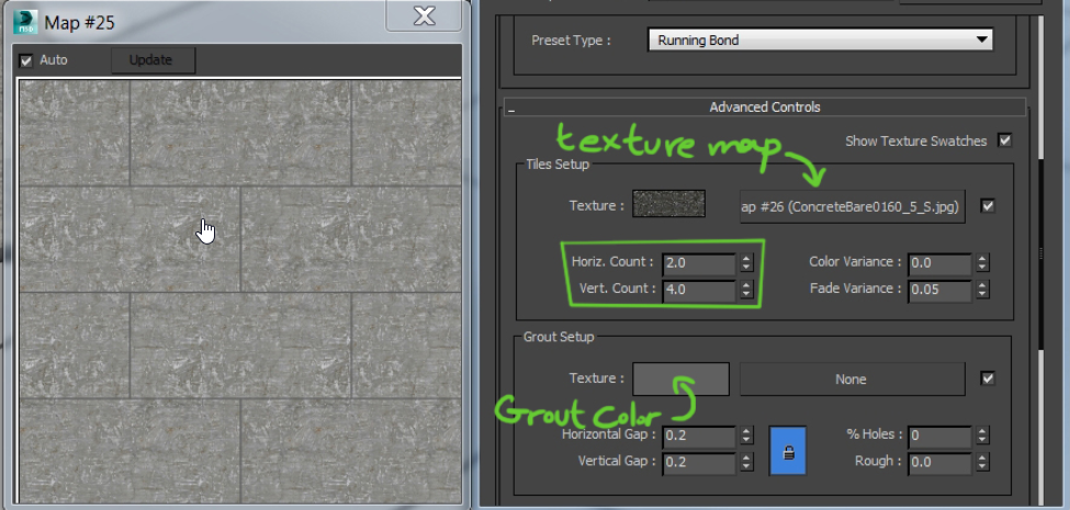

Hi, does anyone know a way to generate a procedural tile texture within octane similar to the Tile Map in 3ds max where user can input texture and play around with settings with the grouting, tiling layout..etc
any help would be appreciated.

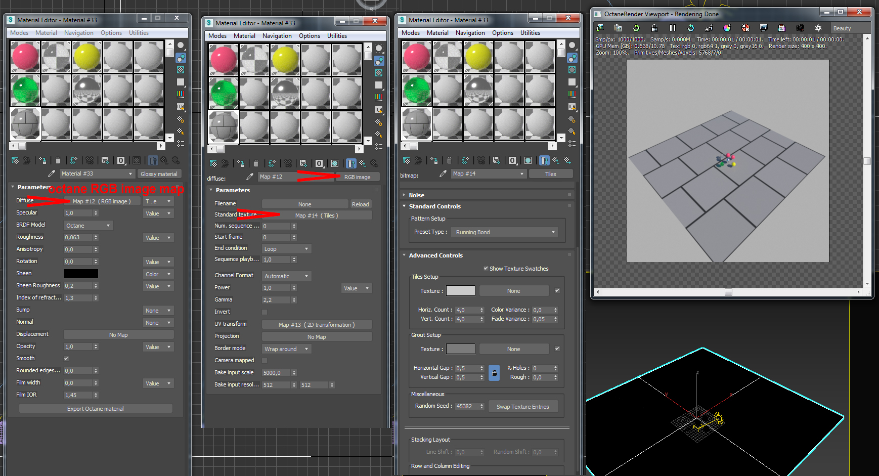

put 3dsmax tile texture in standard slot texture.
Regards
Paride

many thanks ! Is it possible to have a fully procedural solution (through OSL texture maybe?) in standalone without baking in max?
